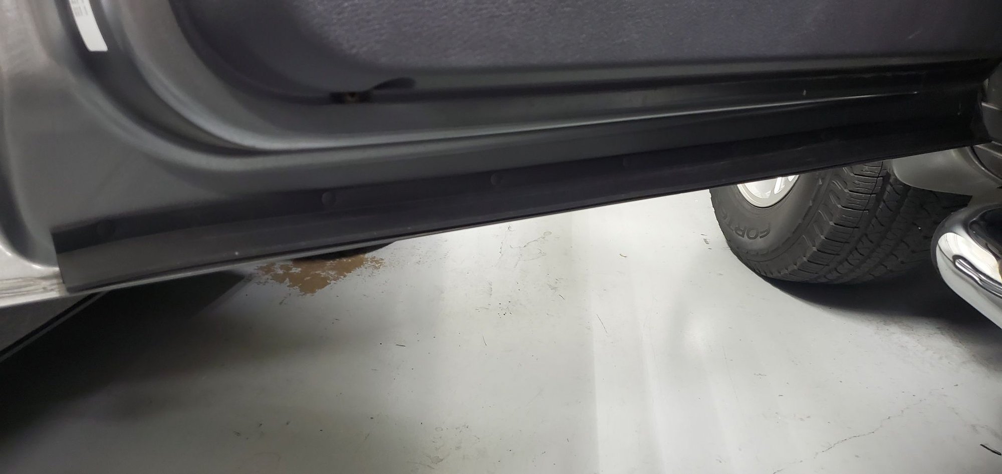

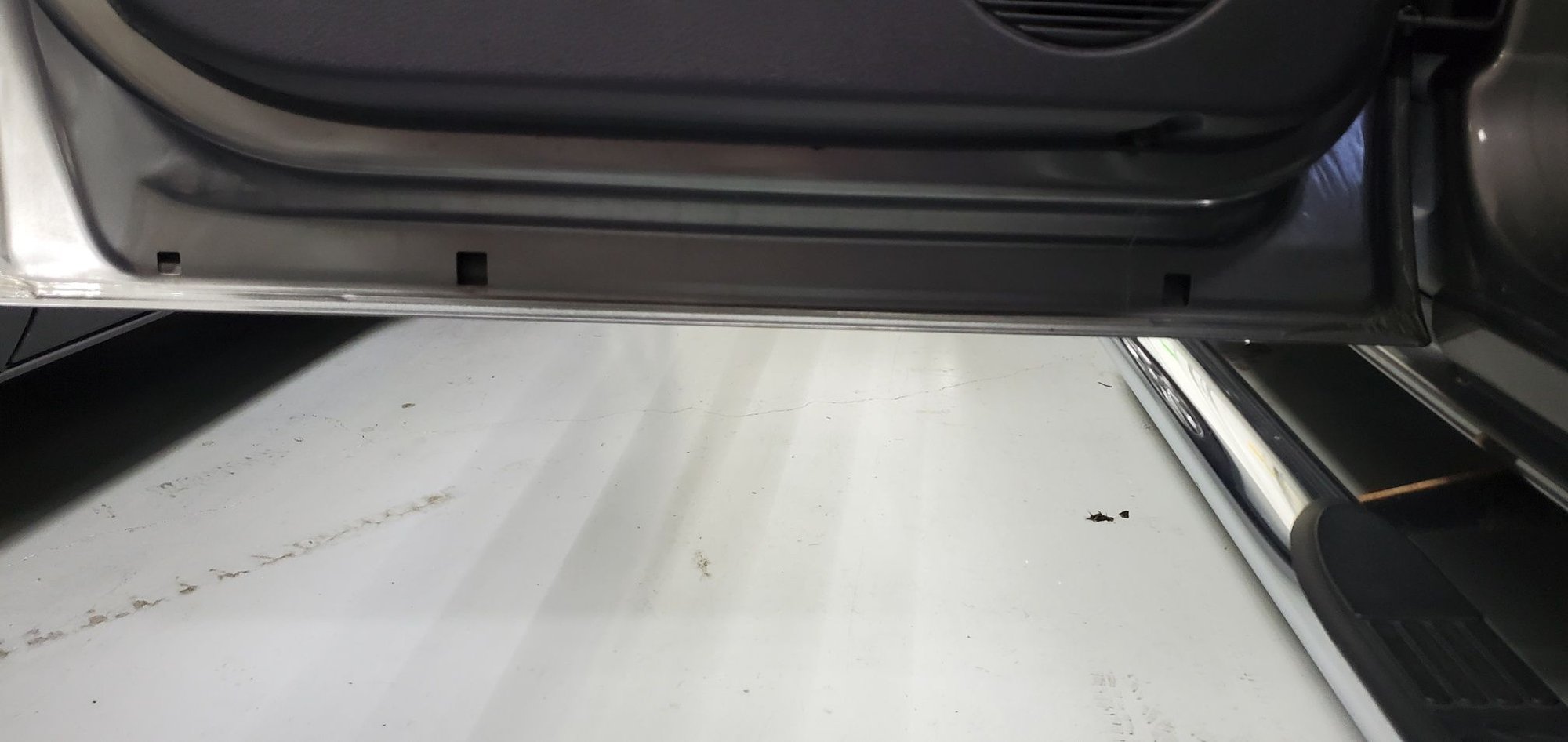

I recently went from a 2008 Extended cab to a 2011 Quad, I had been looking for over a year for one and finally found one if GC with 45K, I had driven several in the year long search and was taken back by the road noise coming from the rear area of the cab. I thought that I could dynamat the rear area to help reduce that sometime down the road, but discovered this weekend that the rear doors do not have any lower seals along the bottom of the doors. The front doors do but not the rears. The seals on the fronts have little push pins to hold them to the door and there are no holes in the rear doors that would suggest that there was ever anything installed there seal wise. I have looked for seals on various Mopar parts sites and see some listed but then A VIN check says they don't fit my model. I don't know if these were left off the truck because it was a last year model and maybe they ran out or if in cheapness they just omitted them after a certain year. Anybody got any ideas?
Front Door seal.
Rear Door no seal.

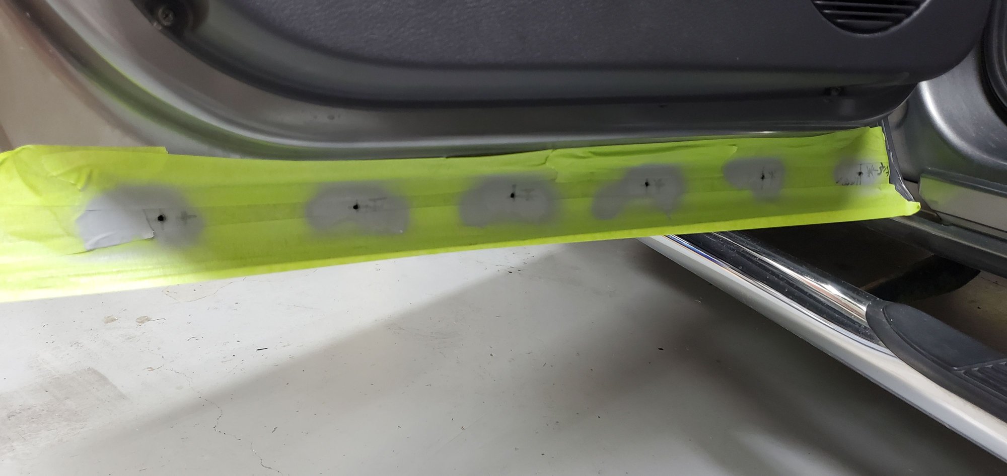

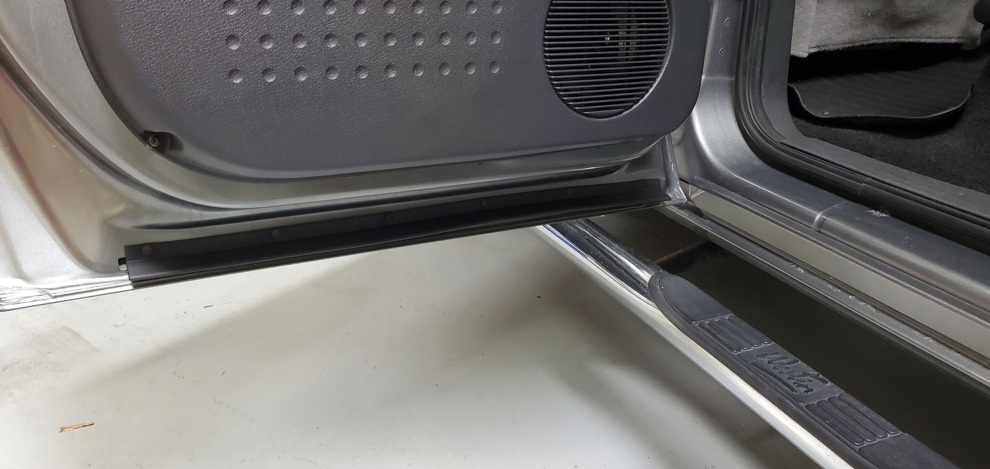

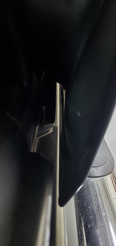

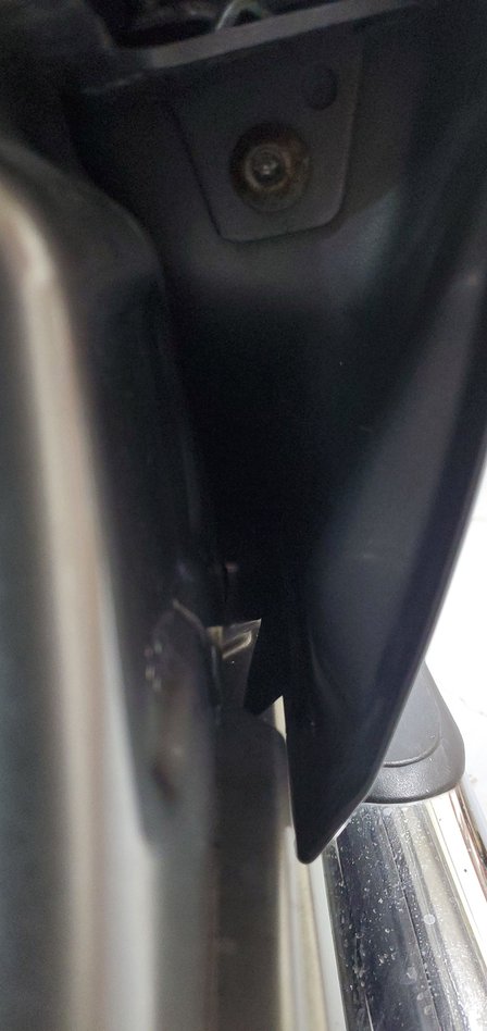

I received the seals and fitted them to the doors, a noticable reduction of noise coming from the rear area. Not 100%, but a reduction none the less. It took all of 40 minutes to measure, mark and drill holes for the seals. A lot of caution is required as you don't want to drill or dent the outer door skin when you drill the 3/16" holes for the push tabs of the seals. I also shot the holes with some primer to prevent any rusting later. First picture will show the gap between the door and sill without the seal and then with them. I had to move the layout to miss the square holes that were already in the door, 3" off the leading egde of the door and 1-3/8" up from the bottom of the door. No trimming of the seals (P/N 55359350AC) I bought and for $17 ea. it was worth it for me.
