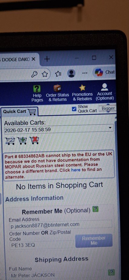

Wow, what's going on at Rock Auto, I am having a bunch of trouble ordering stuff now, because of some documentation issues about Russian steel content most parts. They want ship to Europe or the UK because of this.
Ain't these parts that are MOPAR branded USA made or are they using Russian steel??
Makes it very difficult to maintain the US cars here if it gets worse.

First I have heard of it..... And given the US position on Russia/Ukraine, I would be HIGHLY surprised if there was russian steel in ANY USA made parts...... Now, if they are made in China, that's an entirely different proposition......
I had another order and had the same issue.
Weird but very annoying.
If it keeps happening I can get parts delivered to my Kentucky address then sent on to the UK but it takes so much more time

It appears that their major malfunction is, they want Mopar to verify the source of their steel for their parts..... I can see why that might be problematic for Mopar, they make a LOT of parts, from different manufacturers...... They likely have no idea where the raw materials for most of those come from, and aren't willing to expend the effort to find out...
Not just Mopar parts, but some other brands to on their website as well.
Hopefully just a glitch with new government rules.

I would hope so..... Otherwise, they are doing the 'guilty till proven innocent' thing. That should annoy a fair few people.
