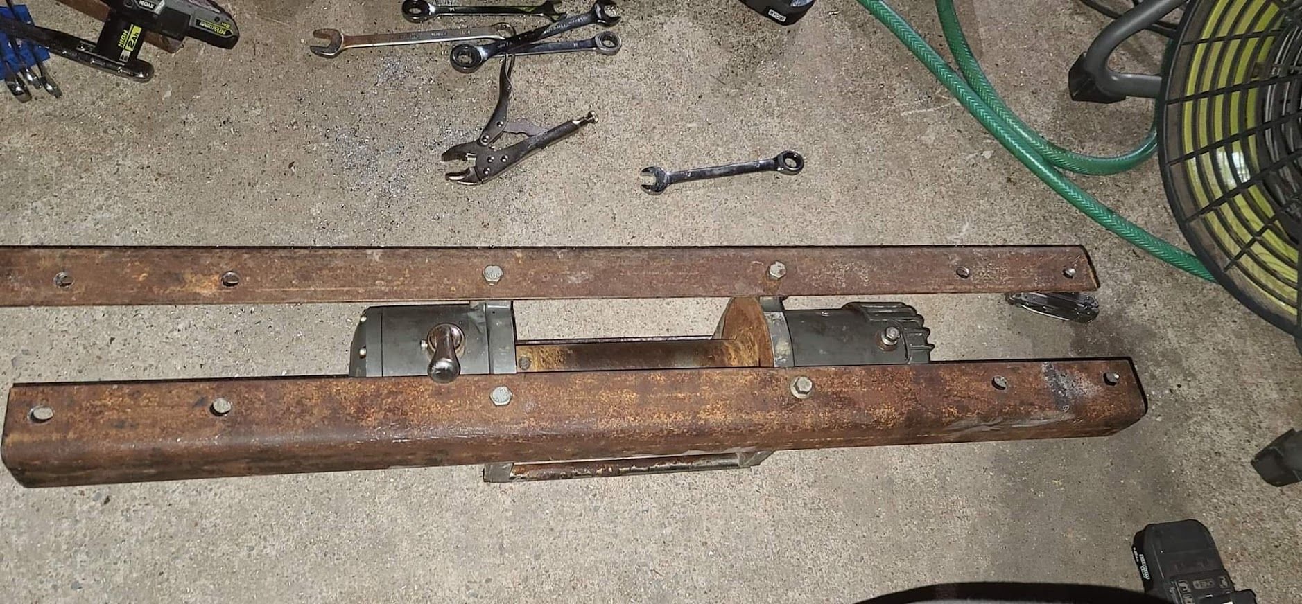

I was gifted a 12,000lb Badland winch. and some Angle Iron drops, so i thought I'd give it a shot. :-)

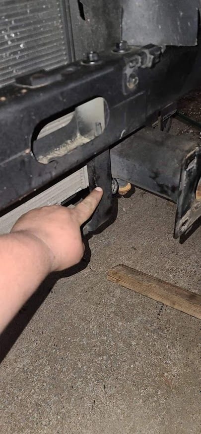

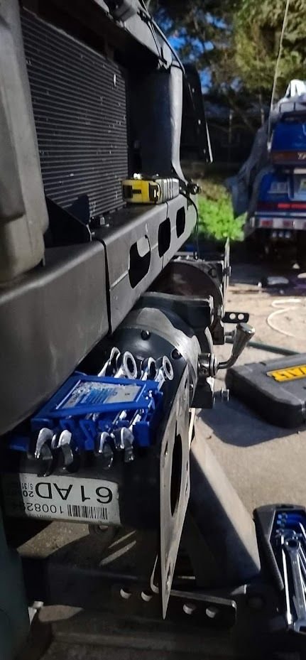

This 12k pound Badland winch will fit just fine, I can either space the front bumper out 3/4" or I can Notch the lower radiator support on one side or the other to clear the motor (See second pic for detail)
This is the Lower Radiator support bar that i'm going to notch and bolt a piece of steel to the back of to restore it's strength
I had to clock the gearbox on this winch to allow the free spool lever to be accessible, I am going to try it like this, but if it's too difficult to get to, I will re-clock the gearbox to have it accessible from underneath the front bumper
This is the Base of the frame I made, I still need to add a LOT of re-enforcement and add some sort of bracing from the winch plate to the fairlead mounted on the front bumper. Or I may decide to add the fairlead behind the front bumper and hide it with a license plate. I haven't decided yet.
My plan is to replace the factory bumper studs with 5/16 Grade 8 Hardware and some Very thick washers. I still need to make the bars that will tie back to the factory tow hook bolts top and bottom.
