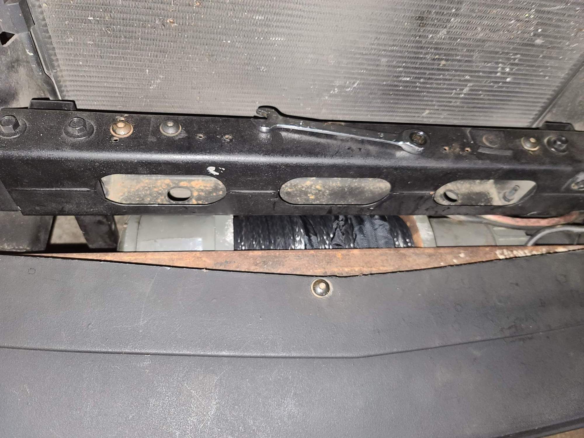

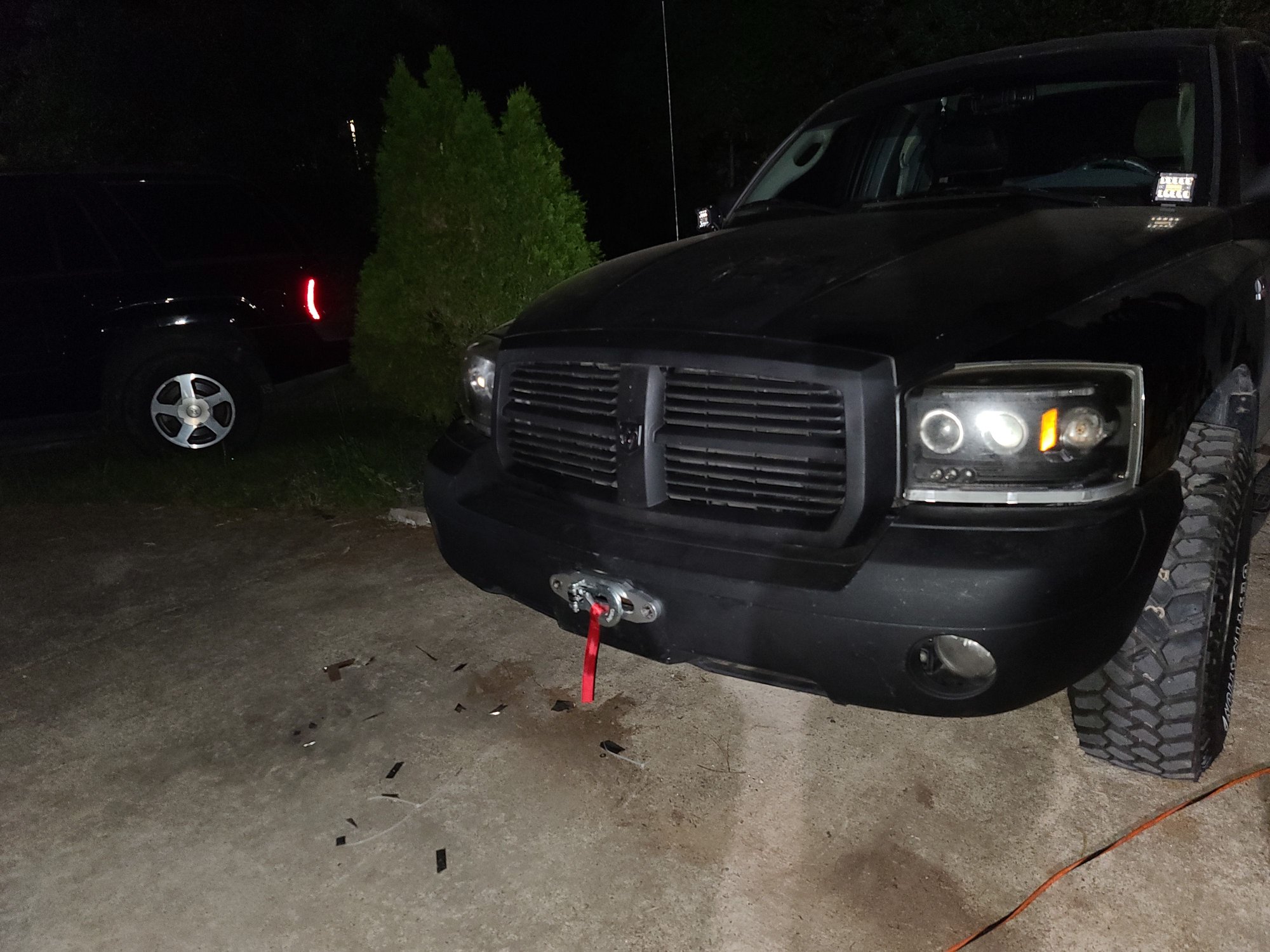

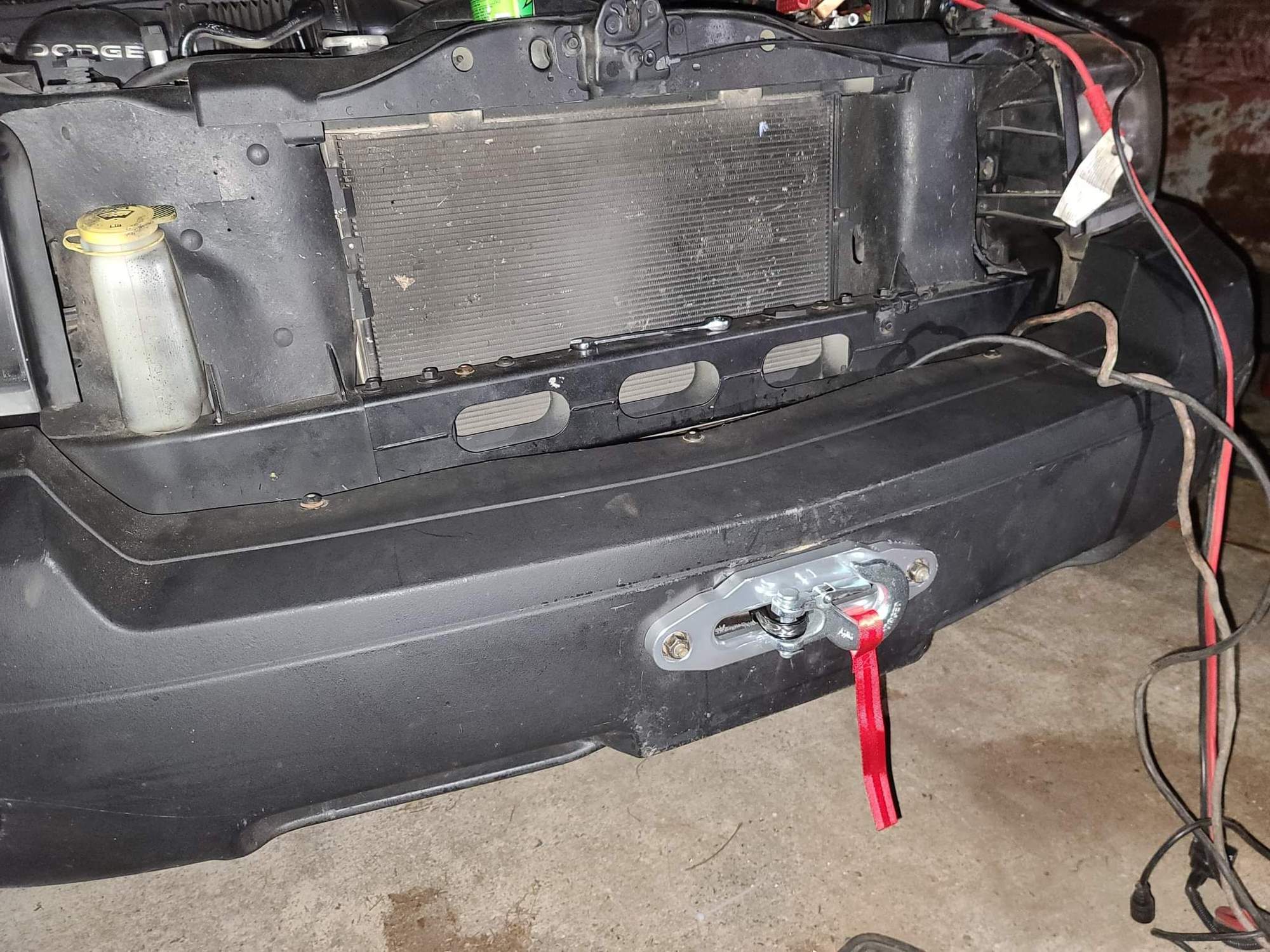

Here are some crappy Pictures of the finished installation.
Fairlead installed to front bumper crash bar and bolted through plastic cover
100ft 3/8 Synthetic winch line spooled onto the 12000 Pound Badland winch
it all fits so nicely. Just had to space the front bumper out 3/8" to clear the lower radiator support brackets. Didn't want to cut anything.
