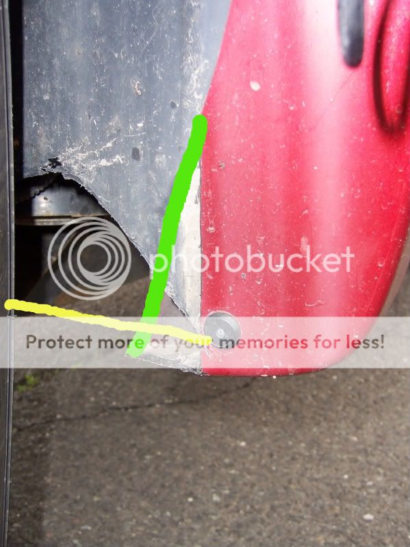

oo by the way i searched but i couldnt find a picture of the trimming you did on the inner fender, if you tell me a post or thread it was, itd be much appreciated

This is the usual spot for 'minor trimming' for the front tire when going with larger tires.
Rear tires should not require any trimming for slightly larger tires. Going too big would also require serious cutting of the front splash guards and front bumper fascia, which could get ugly.
The green line is what I had to trim off of my front splash guards, the bottom has an angle of about 45 degrees.
The yellow line is what I had to trim off of the front wheel well liners, both front & back sides, for the front tires.

Thanks, I think I'll prolly end up with minor trimming of the splash and If it rubs, well it'll rub, and I may space the front bumper out inch , because when I get smaller tires I'd still like to have a inner fender
