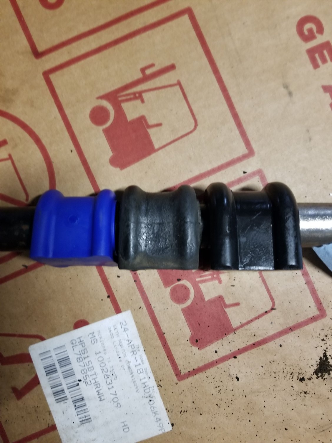

2004 Dodge Dakota SLT, 4x4, Quad Cab, 4.7L
This is kind of a stale thread but I am switching out my front end bushings and having issues finding the right parts for it.

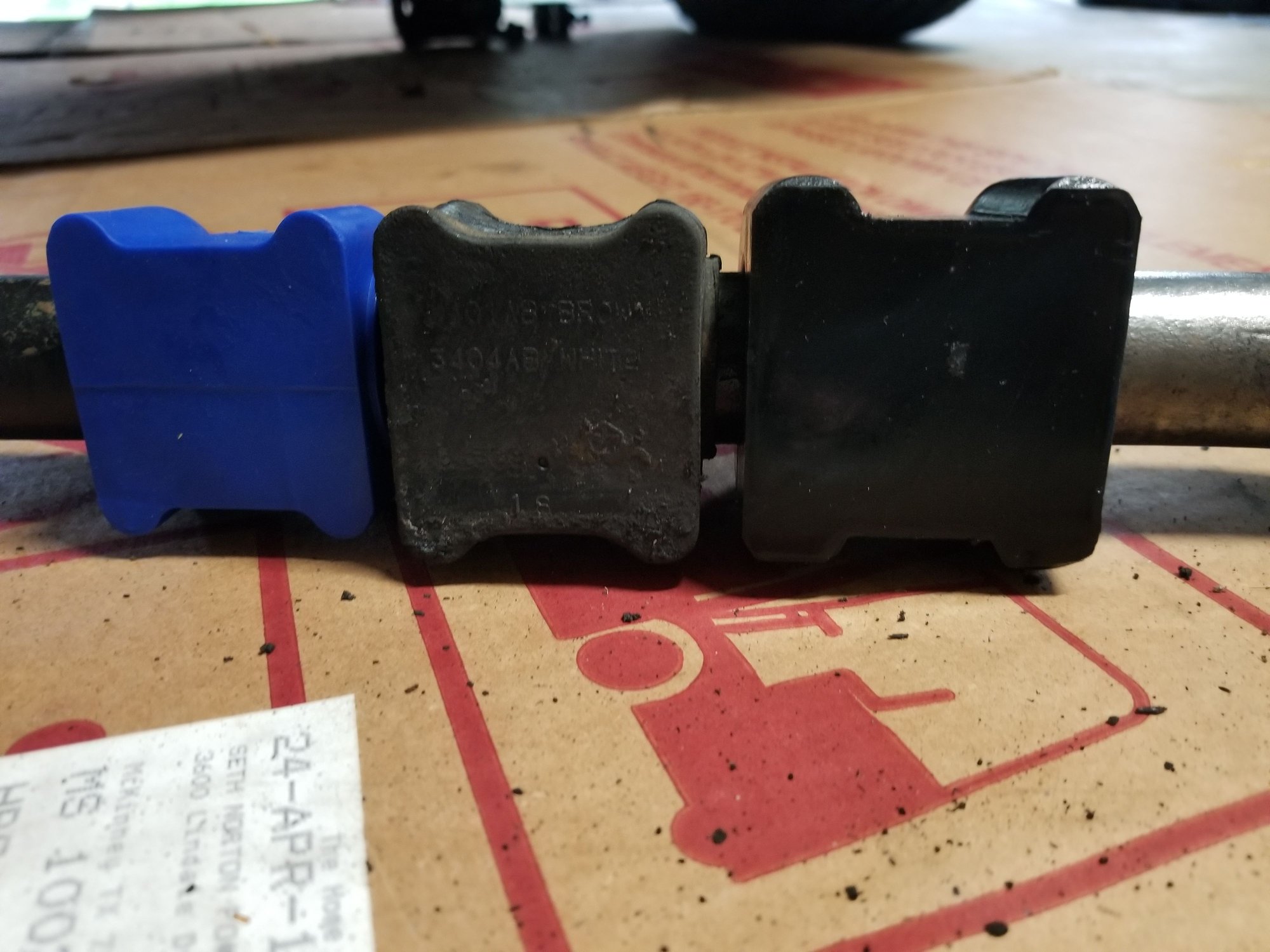

I found these that fit on the ends RAYBESTOS 5501591 Professional Grade; Pack Of 2 (rockauto.com) they are 33mm. My originals were 34 mm but these fit.
I cannot find a 33 or 34 mm for the bushings connected to the frame. Most of the auto stores list my bushings as 35mm which are too big and do not fit. I am feeling like Goldilocks right now.
Any information is greatly appreciated!
Middle one is the original.

How about the Mevotech MK7354?Worth a shot to see if they'll bolt up.

Thanks for the reply daktwos. The blue bushing on the left is the part you speak of, it was sooooo close to being the right size but I am not comfortable with having it permanently installed.
I did stop by a dealership today and asked the mopar team. They say it is a 3401 AB Brown (which is shown in my previous post), but want to charge me $31 each.
I believe I found the part online 52013401AB and listed on a few sites that only show a drawing of the front suspension. *edit* actually found many sites that have photos with the same markings as my initial post*

You may need to shim the saddle bracket to keep from overly compressing.
