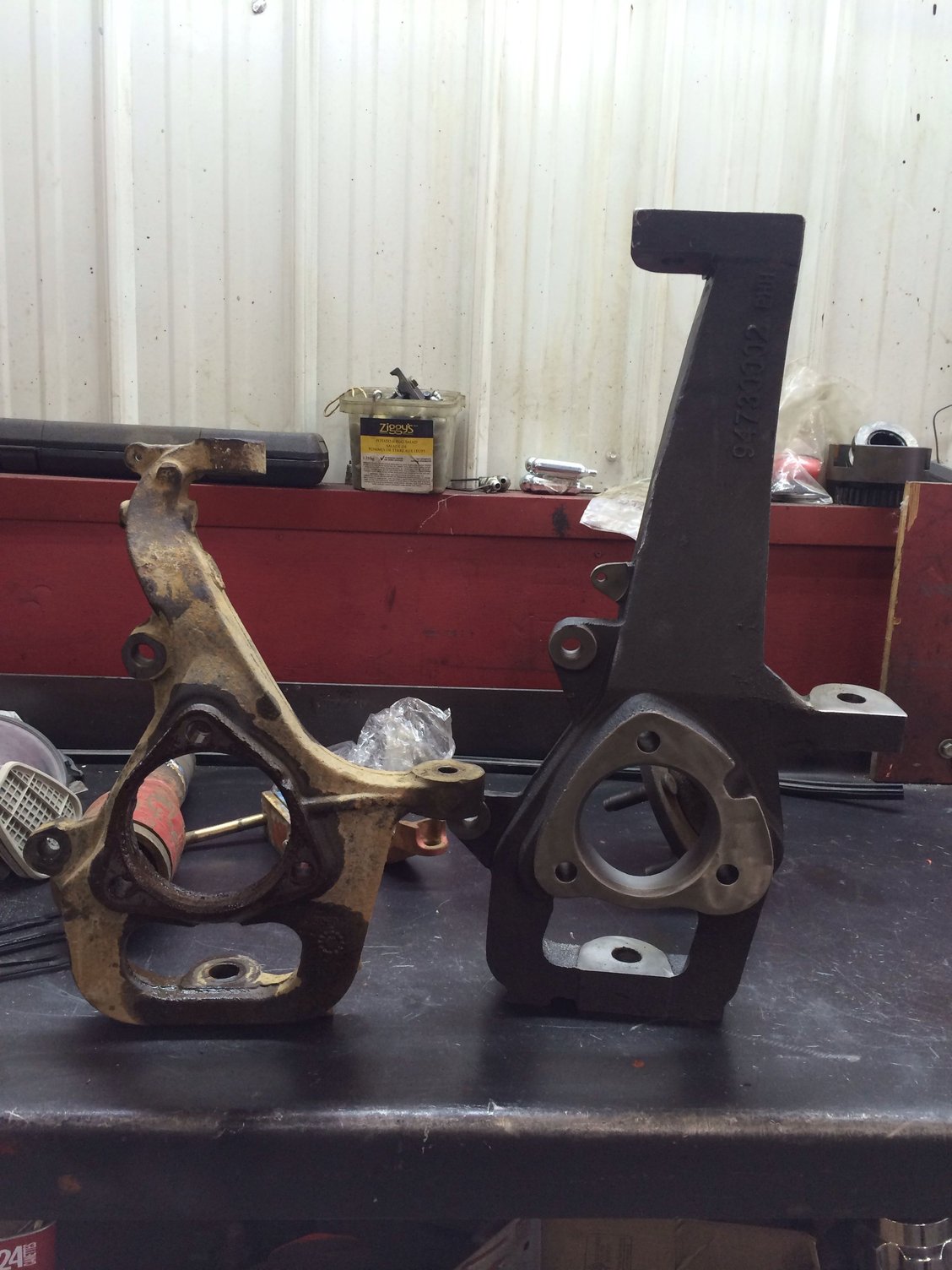

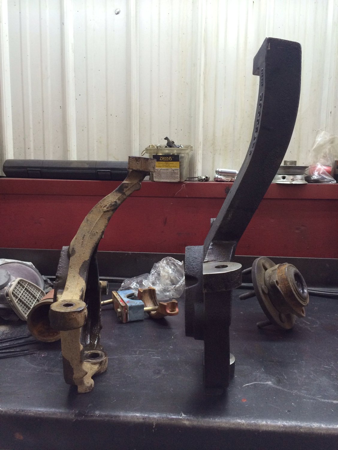

I've compared the new knuckle with the Dakota knuckle and the steering ear sits about 2 1/2" higher on the new knuckle plus the tie rod mounts to the top of the new knuckle ear unlike the Dakota where it mounts to the bottom of the ear so I'm hoping that'll help with the extreme angle I may have to lengthen the tie rods though but I won't know till the knuckle is mounted. Also yes I will be dropping the front diff so I don't have such a bad angle on the CVs, and as far as the struts I am probably just going to build drop brackets for the stock ones for now, the only reason I want Aftermarket is so they're adjustable for a more cushioned ride, plus in the future I'd like to drop a hemi in the Dakota and the adjustable shocks would help compensate the added weight. If you do happen to find that coilover you were talking about let me know though haha, thanks

Ok so I've made some progress today, I've basically gotten the entire front end stripped except 1 seized control arm bolt I'm gonna have to cut but I'm gonna hold off till I know I have a replacement. I compared my new knuckles with the stock Dakota knuckles and they look like they're going to work, only major issue is the tapered mount spots on the new knuckles are deeper than on the Dakota knuckle so I'm going to have to machine them down so the ball joints fit properly. I was hopeing that the front diff drop brackets would all be the same but after getting the diff out of there I see now every bracket is going to be different. I also discovered one of my sway bar links snapped and was rubbing on my CV boot and it tore off and filled it with rocks and dirt so I'm going to have to replace atleast 1 CV now. Hopefully I'll start designing drop brackets and get them made sometime this week. That's all for now.
Tore CV boot
Old knuckle next to new one
