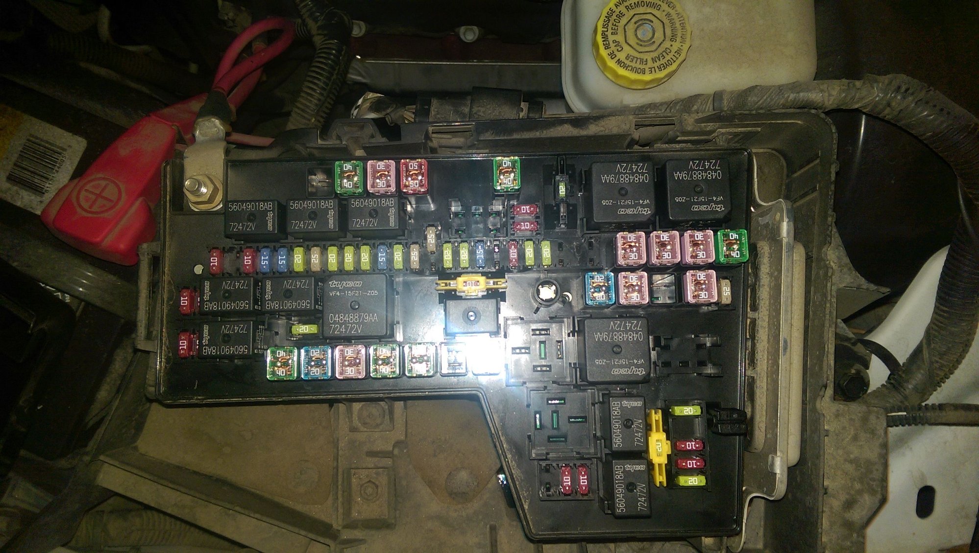

I used a tester light and found that there is no power coming to the window switch from the connectors in the door hinge. The weird thing is that power does come to the power mirror switch which raises more questions:
  1. Why would I get power to the mirrors but not the windows/locks?
  2. What does the junction connector do? It has two big white connectors attached to it will all of wires coming out of the top of them.
  3. Could I be missing a fuse or circuit breaker?
  4. Also, where is the power window circuit breaker? There is no fuse labeled for power windows and the diagrams show a circuit breaker. I've seen on here that fuse #2 or #31 can control the power windows, but my #31 says its a spare. I added a 25a fuse to 31 to test and got power to the fuse, but still not power to the wiring harness.
  5. Is the computer controlling the the windows or not? If so, can the computer be reconfigured to allow it?

Update: I bought a window regulator and motor and connected it but it was a no-go. No power to the motor. I need the correct dash wiring harness since mine does not have the circuit breaker on it, but any other suggestions?
Some people tell me that the FCM controls it, but I've read through all the manuals and the FCM seems to control all of the exterior lighting and what not. Not the windows/locks.
Can anyone help on that topic?
