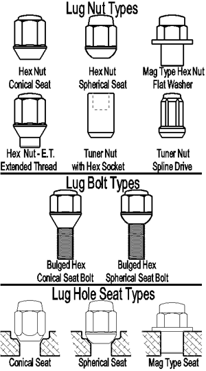

Jegs website says those AR172 wheels use:
Required Lug Nuts: Acorn or Tuner (Conical Seat Only).
I picked up a set of Gorilla Acorn Bulge Seat (91198HT), and used them when my wheels were still unpainted. Using a black set of Gorilla lugs now with the same wheels. Gorilla makes nice solid lug nuts.

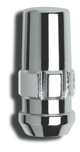

How about these?
I have black ones on my stocks right now. Plastidiped black wheels
Old Nov 15, 2015 | 10:43 PM
vantage08's Avatar
vantage08
Joined: Nov 2012
Posts: 27
I tow as well. Are these less reliable with more weight coming down on them?

I'm not a fan of lugs that need a special key/tool, they are easily removed without the key anyway.
A lug is a lug, and will be fine for towing.
