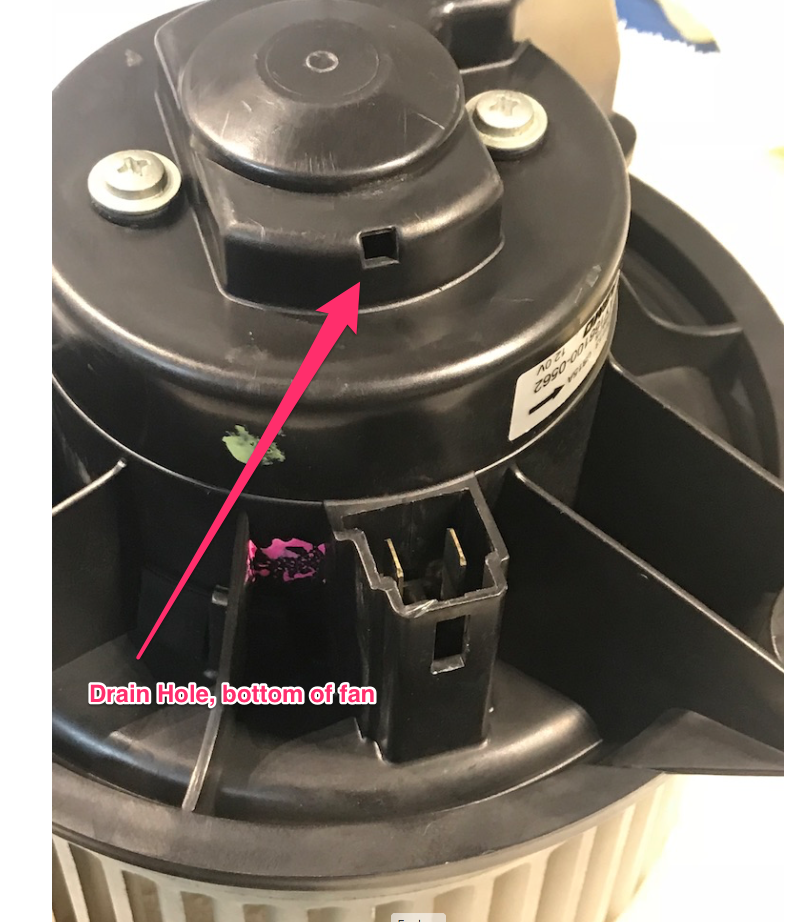

My passenger side leak came down through the HVAC system, leaking directly out of the bottom of the fan enclosure. I tracked this down to water leaking into the system around the fresh air intake - it sticks up like a smoke stack through the body panel that forms the floor of the large area below the cowl, below and in front of the windshield. My truck was parked on a slope, nose up, so there was pool of water around the intake stack and it leaked in. I sealed it all up. This picture shows the intake, it is very hard to see even with the cowl cover off, as it is tucked up under the base of the windshield. I first used expanding home insulation spray foam called "Great Stuff", but later learned it is not waterproof so I surrounded it with some urethane seam sealer.
It was cool to disassemble the fan and look up into the HVAC system, it is a direct shot straight up to the air intake. Also the fan is designed to handle and divert and drain any water that comes its way and drain it out of a hole on the very bottom of it.
