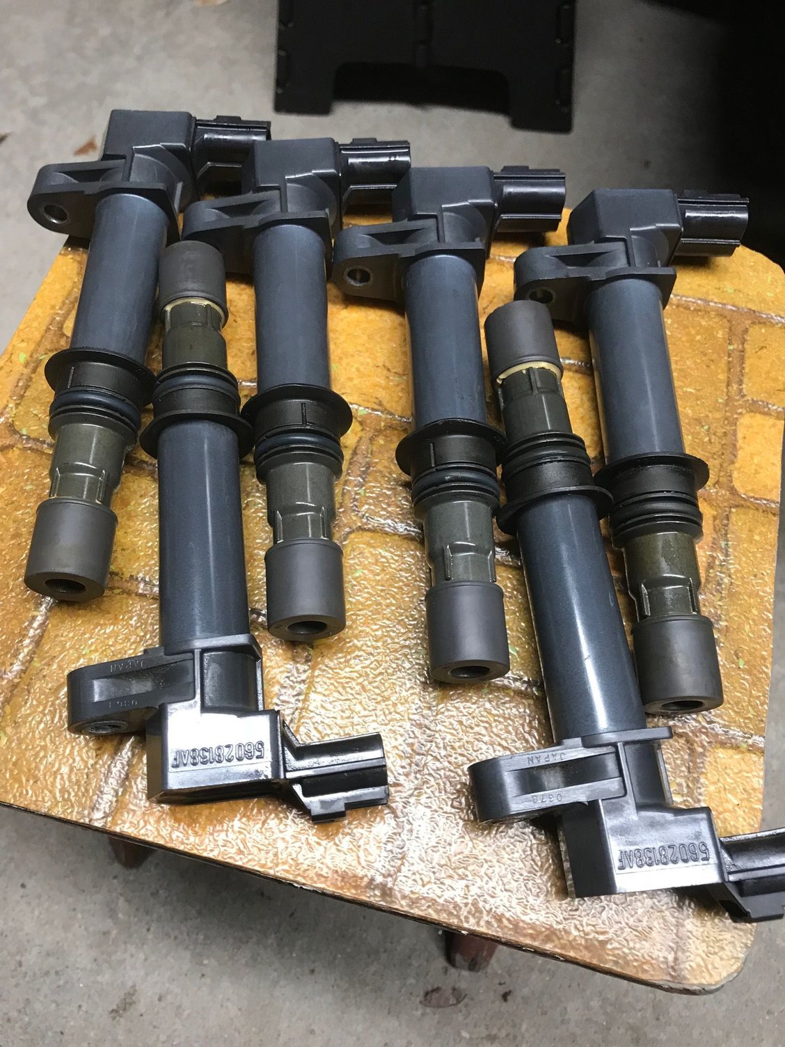

Truck started up without issue and was running well. But then just yesterday I had the MIL light flash again indicating P0300. When home from work I changed the oil (Mobile 1 full synthetic and filter) and also decided to inspect the coils and spark plugs. When I took the spark plugs out I noticed pretty much all of them had a black ring right near the electrode, where the first set of threads begin. I do not know for sure, but I suspect that this is melted/burnt anti-seize. I used Permatex Silver Grade. Did I make a mistake for using anti-seize on the spark plug threads? I tried to use as minimal as possible but I could see how the anti-seize could have melted from the high heat and drip down towards the spark. This interference could definitely cause misfires, right? As for the plugs, the tips were okay, a couple seemed to be gapped slightly off and I fixed them before reinstalling. I also bought a product called Wire Dryer and sprayed this right up and into the coil where the spring is, this is supposed to remove wetness from electrical connectors. I moved the coils around to new cylinders and put everything back together. This was only last night but I did take it for a short drive late last night and it has gotten me into the office today.
Here are pictures of the coils. What do you guys think in terms of condition? There is some browning on the outside and inside of coil, I tried to capture in the pictures. My neighbour (class A mechanic) keeps telling me that any misfire issues are causing by bad plugs or bad coils, so I just wanted to see what you guys think?
