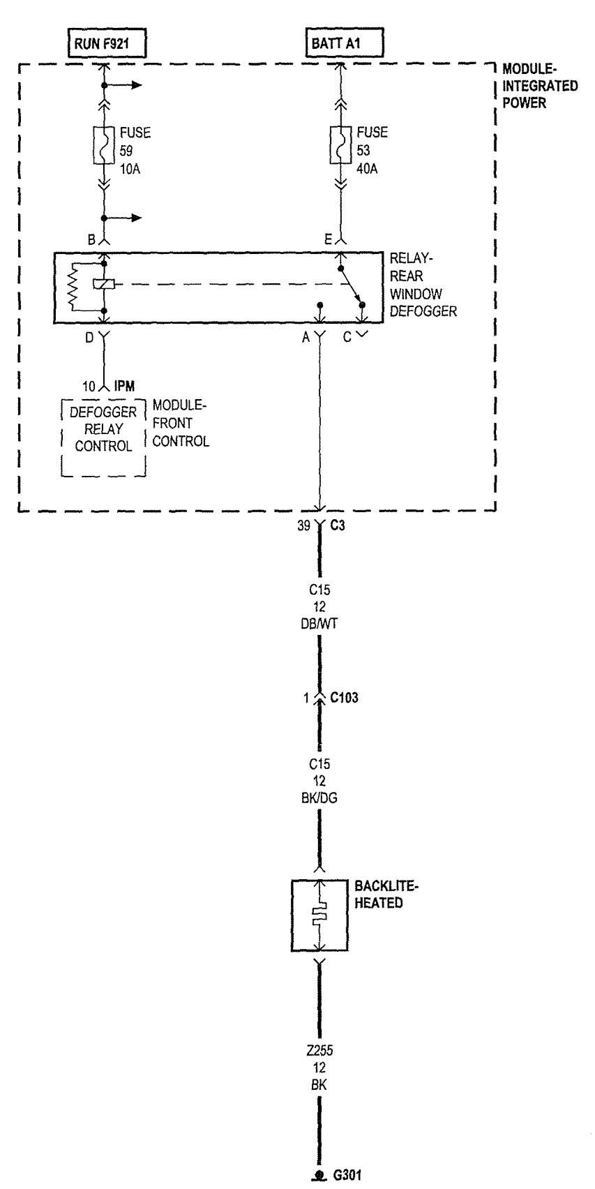

Here's a few more diagrams:
2009 Dakota Laramie Mirror Wiring
2010-2011 Dakota Laramie Mirror Wiring
2008 Dakota Laramie Heated Backlite Wiring
2011 Dakota Laramie Heated Backlite Wiring

Thanks again for the additional diagram post Philipat the more I look them over it seems to make more sense to me I'm still hoping someone will pick up on this who has completed the project be nice to help guide me through the unknowns.
