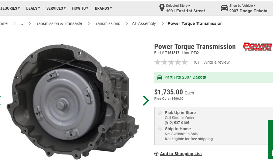

My question is, I've noticed that most of the ones I'm looking at online have a 3 year warranty- is that like null and void if the part isn't installed by a certified shop? I figured since most of y'all are DIY-ers that you may have some insight on this.
Also, do any of yall have recommendations (or horror stories) for any of the transmissions in the images that I've attached below?

the warranty conditions are pretty much standard for all trans rebuilders/suppliers.
not sure what failed on your old trans. be aware that the external cooler if equipped, cooler lines, radiator cooler lines all need to be flushed or replaced. particles from a failed trans will circulate through the valve body, tc, and cooler lines. If not removed they will damage the new trans. dealerships have specialized equipment that heat the fluid to temp and flush out the external coolers and lines and flow test the lines. Cold flushing may leave debris trapped in coolers or rads. have someone in the know look at the old trans and fluid condition!
once the new trans is installed...the trans module must be relearned to reset the adaptive memory.

First of all I wouldn't buy a transmissions from Orileys, get one from a place that specializes in transmissions. Also flushing the lines and reseting the computer aren't as hard as people make it out to be, you can get a kit to flush the lines at most auto parts stores, and unhooking the battery for a while is all that's needed to reset the TCM.
