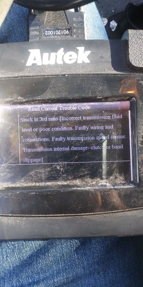

2005 dodge dakota slt 4.7 wont shift into 3rd gear have a po733 code anyone have any ideas ive changed the pcu tcm valve body an solenoid input output speed sensor it is saying low fluid witch i just changed an also bad wiring

It could be a number of things.
You said you just changed the fluids, any debris in there?
Did you use OEM filters? (There are two filters in the 545RFE.)

yes i used oem filters i did it 2 times it was clean i will double check my speed sensors i did replace them but maybe a wire got messed up
