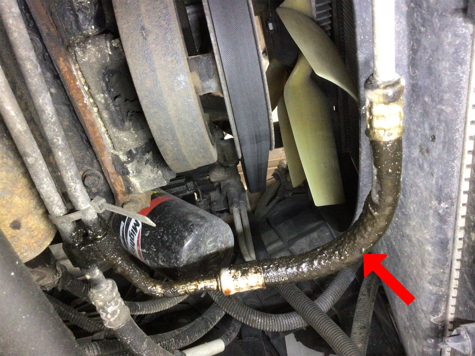

As I was doing this I realized that there is no separate trans cooler, just a loop of tubing in front of the radiator. Is this all we get as a trans cooler? The trucks build sheet says factory installed tow package, I would have thought for that there would be a separate radiator for trans cooling.
I am thinking about getting a trans flush but bought the vehicle at 105K and now with 124K if I should as I have heard horror stories about changing the fluid in older transmissions.
Oh, the trans lines, yep, leaking, sorry about the huge pic, copy/paste...could that be contributing to the light? I checked the trans fluid level, a touch below the hot, but not to the add line.

I would replace the transmission cooling lines before the leaks get worse. Just did mine and installed new lines instead of splicing, PIA.
