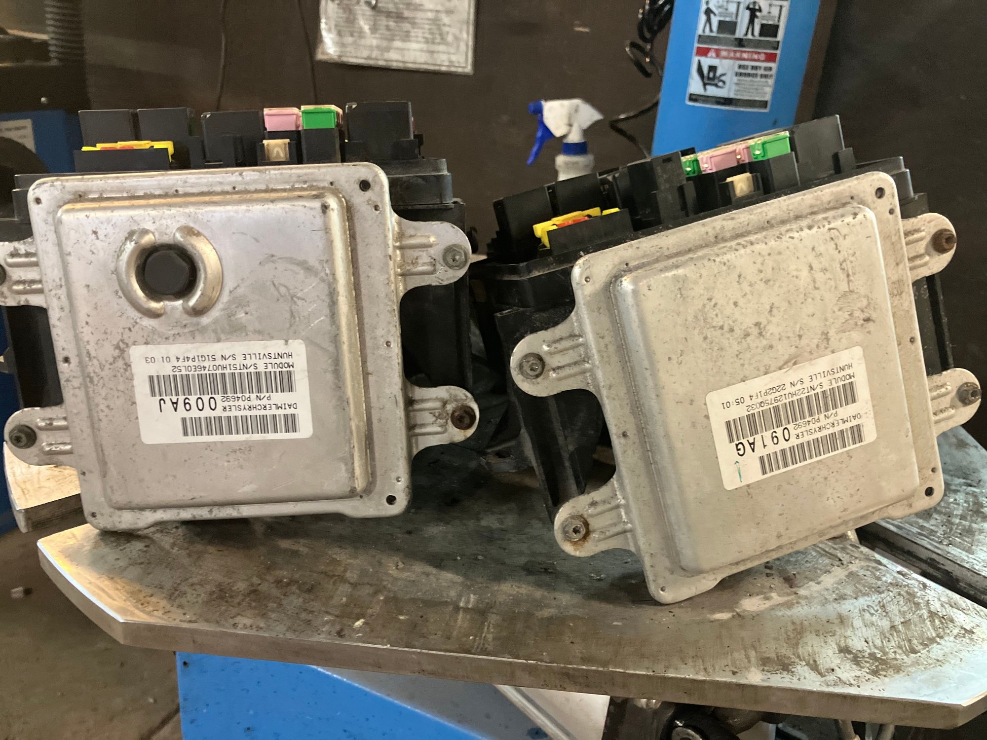

So my speedometer wasn’t working. I replaced the sensors(on the rear diff and the drivers side wheel bearing.)No joy with that. It’s at the shop, mechanic said new tipm, said it was burnt out for the abs which controls the speedo. Got one from the salvage yard. Still no joy. He says the modules are not the same. I’m having a hard time finding the correct one.
The left one is the one from the salvage yard. The right one is the stock.
2007 Dodge Dakota Laramie 4.7l V8

You may end up needing a re-program of VIN from a junkyard model even if it is the same model. A place like this might be able to help.
https://circuitboardmedics.com/tipm/

Does the truck run fine, otherwise?
