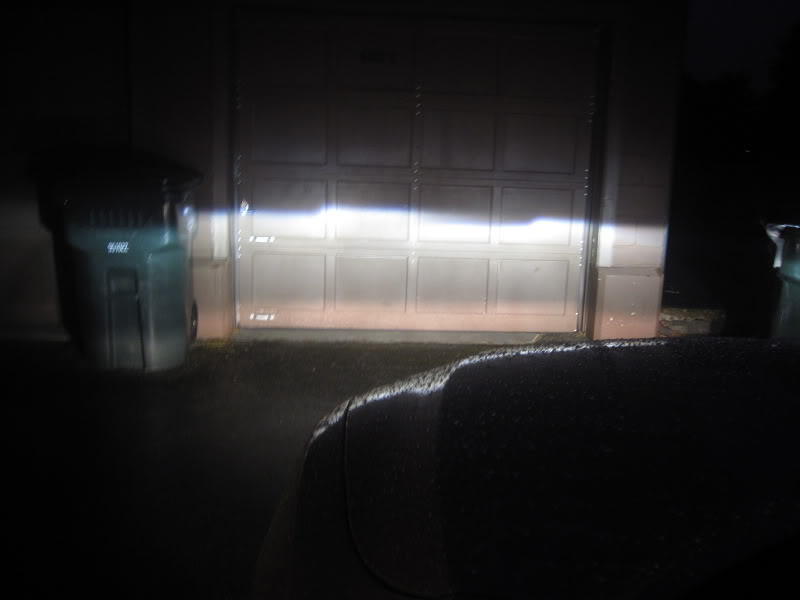

Can someone who has the factory HID's take a picture of the output of the HID on a wall from about 25ft. away at night? I am trying to see if they have decent output. I just tore open a halogen headlight for retrofitting but these headlights are an absolute B*TCH to work with...

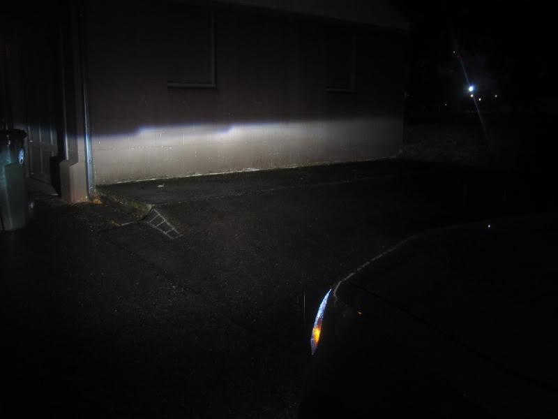

Not the best pics but I hope it helps. Was raining so I did my best. First was taken about 25 ft. away, flash was on. Second, 25ft. flash off. Third was taken at less than 10 ft.
I'm definitely into the look of projectors and these factories are great! They are a nice clean and bright beam in my opinion. Sounds like you may have more experience with projectors seeing as how you are doing a retro fit. Also, to get a really good look at the actual beams just go to your dealership and check them out in person. Just a thought.
Let me know how it works out....

The factory HID's are actually very good, by any test standards. I have a source that is in the automotive lighting industry that has actually commented that the Durango HID projectors are quite good. This is a divergence for Dodge, as their lights have historically been sub-par.

those arent that bad, very nice! thank you so much for taking the time to shoot the pics. I wonder what projector they use...
