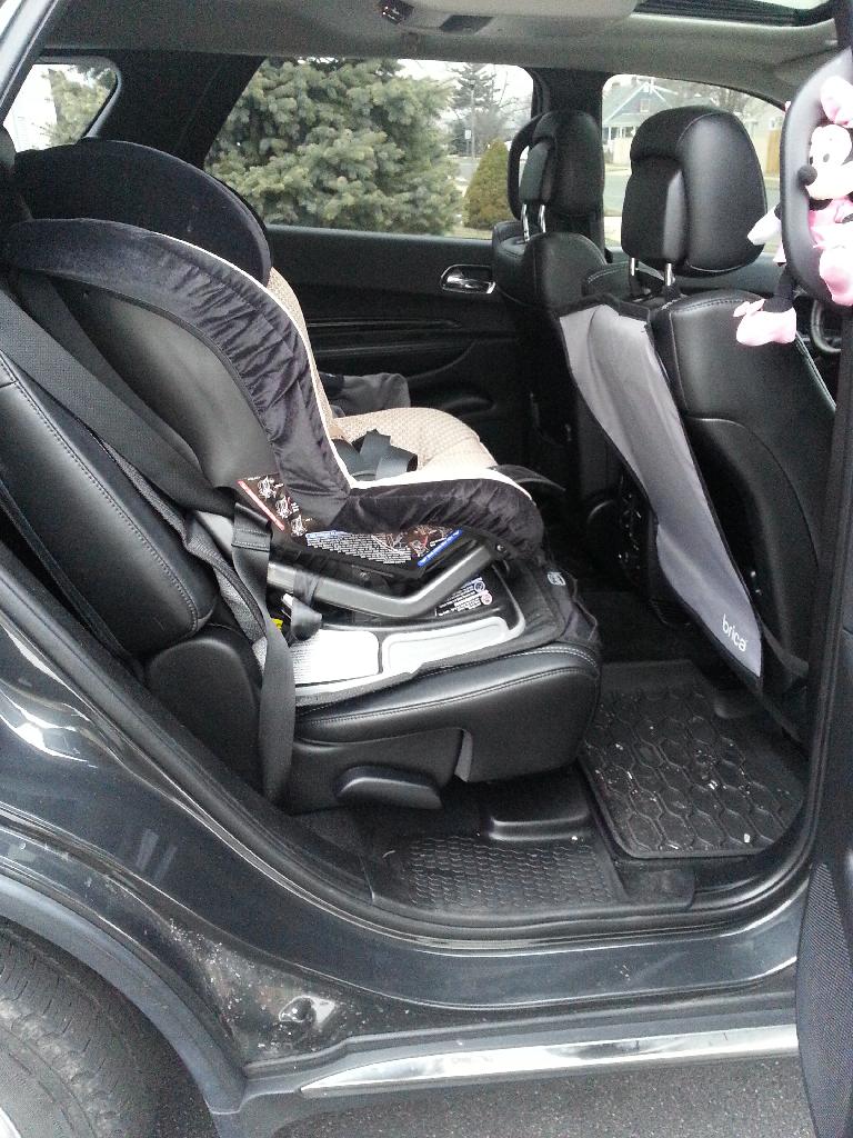

I think ......and this is just my .02 but the correct installation of the car seat is the first most important part. I have a Britax Boulevard 70cs and I remember that it had the feature of being able to slide the seat in its cradle back and forth.....what exactly this was for I have no idea because the instructions indicated that once front facing that the seat had to be in the up right position. I do recline the seat a little so my daughters head isn't hanging forward when she falls asleep in it but I just got back from a trip with my wife and she wanted to drivemy car for a bit......I thought I was going to be in trouble being I'm 6'3" witha 32" inseam and my wife is 5'4" well turns out I didn't have to push the seat back and I was very comfortable that Ifell asleep almost all the way home.

The seat is being secured by the seat belt, rear tie down anchor, and the seat anchors. I was told just recently by the dealership mechanic the the seatbelt is not necessary when you have the other 2. I don't think the additional seat belt will do any wrong but that is just my opinion.

Is that seat installed with the LATCH anchors or the shoulder belt?

Is the shoulder belt just stuffed in the belt path then?

I am a CPS certified technician/installer. The reason i ask is it looks like the latch anchors are tight. Good. It also looks like you've got the shoulder belt run through the belt path. As well. Use one or the other. Shoulder belt or latch anchors but not both.
