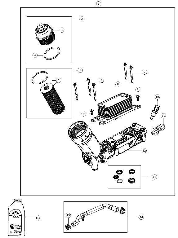

Per the options, the tow group includes an engine oil cooler, but I can't seem to locate it. I see the transmission cooler and the power steering cooler, but do not see an oil cooler.
Anyone know where it is located?
I looked for a front mount air cooler, as well as a laminova style liquid cooler, and do not see either.

So I found out the oil cooler is a Laminova style cooler (coolant to oil heat exchanger) and is located within the oil filter's housing.
