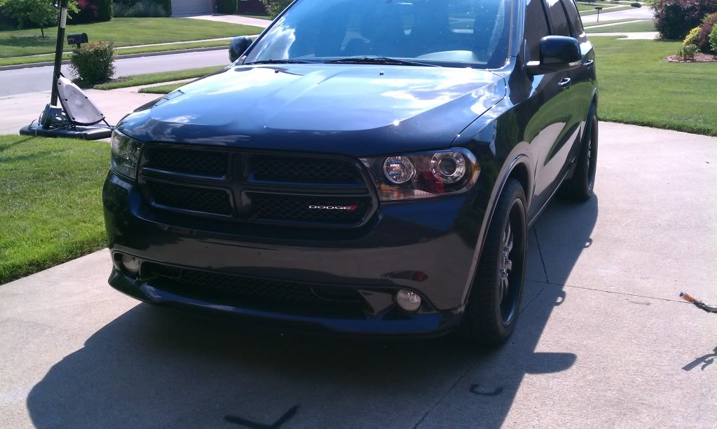

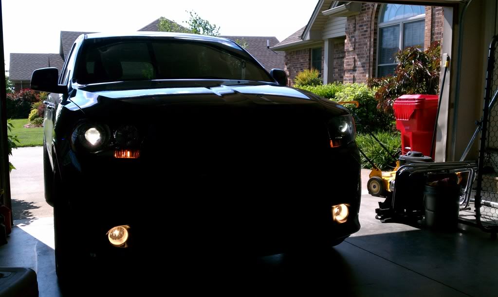

Old Jun 8, 2012 | 05:03 PM
Scottina11heat's Avatar
Scottina11heat
Joined: Mar 2012
Posts: 908
From: Kentucky
quick cell pics of the hid lamps installed

Nice job Scott!

From: Kentucky
sorry for the crappy pics...the sun is brutal today!

Well done scott, they look great!

thanks! I made the harness using the repair harness for the drivers side. But for the pass side....I bought a 09 caddy d1s ballast with the power cord and bulb cord. I modded the power and ground to connect the canbus fix harness and cut a small hole to feed the bulb cord through and it works PERFECT!
