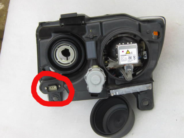

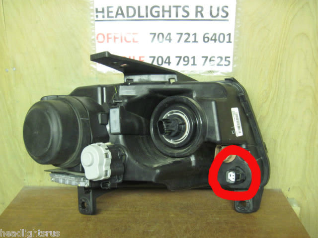

OK....this should be easy! Just found some pics of grand cherokee hid lamps. You can see where the harness plugs into the lamp. I have circled each in red. Looks like I can unscrew the passenger side and pull the plug on the drivers side to access the wiring for the ballasts. Easy peasey FOLKS! Look for this to be done soon!
