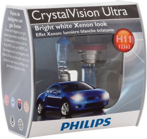

Yes, only shaved off one tab using an Xacto knife. I got Philips H9 from Amazon for $7.76 each. H9 bulbs are 65 watts. Sorry but I don't know about the rest of your questions.
You might also want to explore these. They have good reviews.
