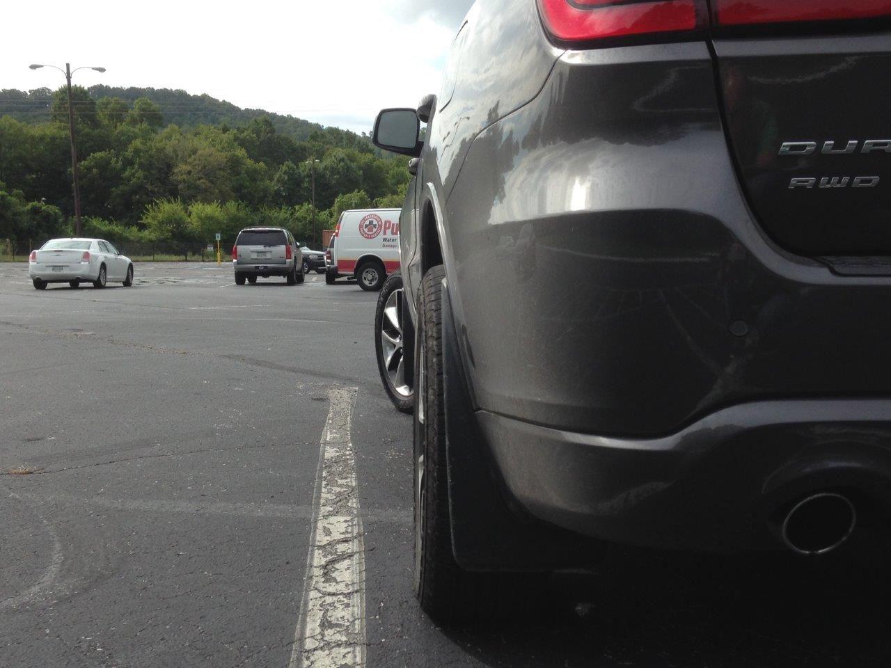

Kit went on with no problems. No alignment issues. Tom's 4x4 of Chattanooga billed 4.5hrs plus alignment (was their first install). Drives the same. Pics have stock wheels with 1.5" spacers and stock tires.
