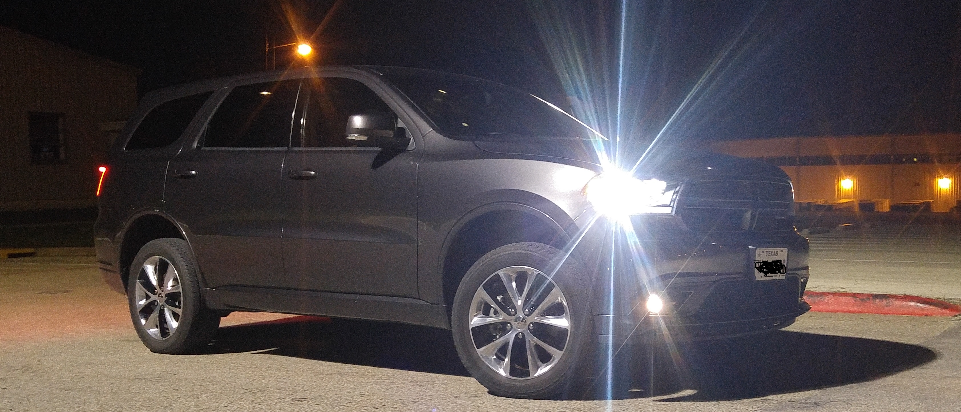

I put the 2.5" Rocky Road Outfitters full lift on last week. Purchased the "deluxe" kit here, http://www.rocky-road.com/wk2-lift-kit.html, for $788.96 out the door. It came in about 2 weeks.
Kit included all necessary hardware, two rolled steel upper control arms (much more heavy duty than the pressed sheet metal stock ones), two Moog Problem-Solver ball joints, two upper puck style spacers for the front shock spring assembly, two upper plate spacers for the rear shocks, and two puck style spacers for the rear springs. Bottom line, it's a puck spacer style lift kit using the stock suspension. Don't get me wrong though, it is heavy duty plate steel NOT $75 cheap rubber bushings. Each puck weighs about ten pounds and is nicely powder coated black.
As for install, it took us (one seasoned shade-tree mechanic and one guy who likes tinkering) about 5 hours total. The first front shock we did took about 2.5 hours, but then we had it mastered. The directions they send with are pretty good and have pictures too boot. If I can say anything, lay out EVERYTHING before you start; we tried laying out just the big stuff and leaving the small lose-able hardware in the bags but it ended up biting us...
Tools you'll need:
-at least two decent height jack stands
-a good jack with at least 3' of travel so you can lift the vehicle a decent ways
-a tire iron
-ratchet and wrench set (we used a lot of 18mm, 1", and some others if I recall so it takes a decent set)
-a grease gun with chassis grease (for the ball joints; they looked greased but the instructions called for grease? we topped off)
-a rubber mallet to knock stuff lose or into place without causing damage
-Some rust buster spray for loosening rusty bolts
-some light gauge locking wire to 'tie up' and hang the knuckle while it was detached came in super handy
-two guys... this would have been a bear to do alone
Tips that aren't covered in the directions (or we just missed them):
1. On the front passenger side is a suspension height sensor, which they mention disconnecting but I don't remember seeing anything about swapping hardware in the directions. Remember how I said lay everything out so you know what you have? We put the stock sensor attachment on the new control arm and it was way too long and wouldn't allow the arm to travel without contacting the frame... pondered that for a good 15 minutes till we just shrugging and put it all together. Then realized that there was a replacement attachment for that reason in the kit... had to take it apart and do it all over again.
2. Loosen (but don't remove) all the lower control arm alignment bolts. It gives you the necessary wiggle room in the control arms when it comes time to reattach the shock to the arms. You'll need to get an alignment anyways so it's no big deal.
3. The instructions mention multiple times to watch how far you move the loose knuckle to avoid damage to the break lines. Unless you have someone who doesn't mind sitting there holding the knuckle through the entire job, we suggest using some locking wire to "hang" the knuckle from somewhere on the frame. Free'd up out hands really well.
4. The last step that isn't mentioned too often, but is very important, is the alignment. Most quick-lube style alignment shops use software now-a-days to put vehicles to a factory spec. You'll need to find a shop that has the equipment and experience to work on aftermarket suspension mods and not just tune to some numbers in a book. Even with the experienced shop I used I had to coach them a little to find all the different adjustment points and to keep trying till they got it to where I was comfortable. They got it within tolerance but it's not perfect. These Durango's aren't meant for this kind of suspension so I'm not surprised it was a challenge.
Sorry I don't have more in-the-moment work pics, but we were getting after it. After a week of driving on it I've noticed a couple things:
1. It finally has the stance of an SUV; looks awesome. Now all it needs is some wheels.
2. The suspension does seem a bit stiffer, taking railroad tracks and big bumps with some more bound and kick, which makes sense since the springs are basically preloaded now. No risk to safety though.
3. There's a tiny intermittent squeak coming from the rear drivers side that I can't identify. It sounds exactly like a mouse...
4. There's a rubber friction squeak coming from the front upper control arms, usually only when I brake the front end strokes down a little. I think we may have over tightened the frame attachment bolts and it might be pinching them too much, causing the rubber bushings to not have enough wiggle room. I plan on talking to tech at the dodge dealership when I go to get my headlights adjusted and see about the torque specs.
5. your headlights will be permanent high beams unless adjusted thanks to the leveling feature of this lift. If you've got the HID projectors then I think you'll need tech support to have them adjust the auto leveling in the computer.... damn technology.
...almost forgot, shout-out to xsheenx, Thekoning and NYHunter1 for the inspiration and for being the guinea pigs
