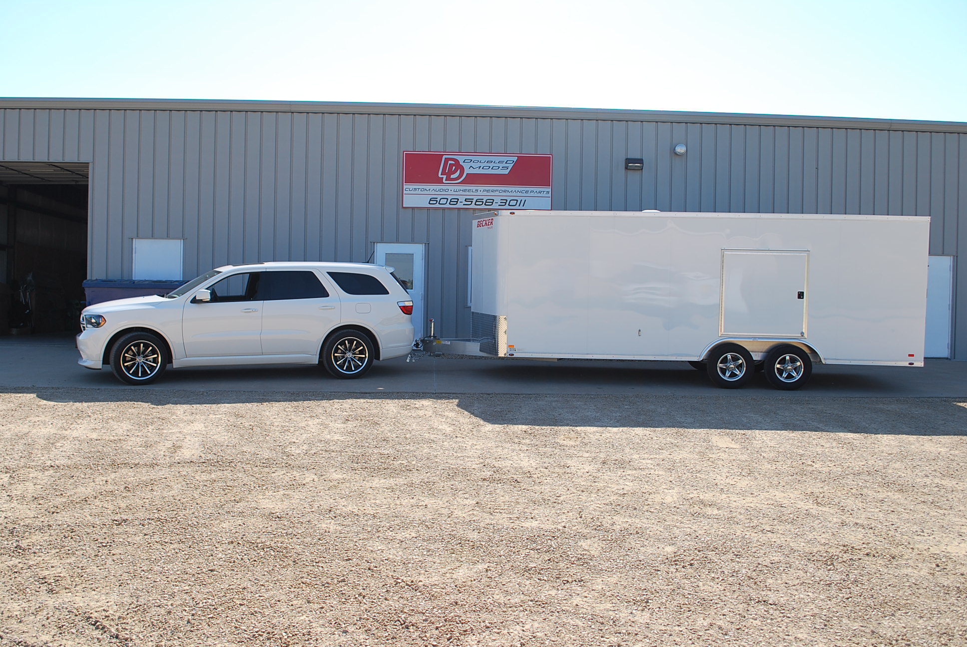

You'll be fine with the Hami, as long as you can get the tongue weight within spec.
Hemi has a 7200lb towing capacity
The V6 has a 6200lb towing capacity
I towed 6000lbs with my V6 and it performed great. I did back the car onto the trailer though, to get the tongue weight sorted.
you will be fine
expect around 10.5-11 mpg with 91 octane fuel.
We did 2500 mile round trip with our 2200lb trailer to haul back a 1929 Model A.
Not one single issue and the Durango pulls the trailer like nothing is behind you
