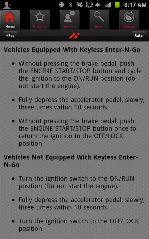

Its all duty cycle based on your driving. You can't change the interval times and if you get the "oil change due" message here is how you reset it yourself I took a screenshot with my phone sorry if quality is bad

I'm sure if you change the oil before the message pops up it will automatically reset but once the message is lit it won't auto reset cause its a warning message.
