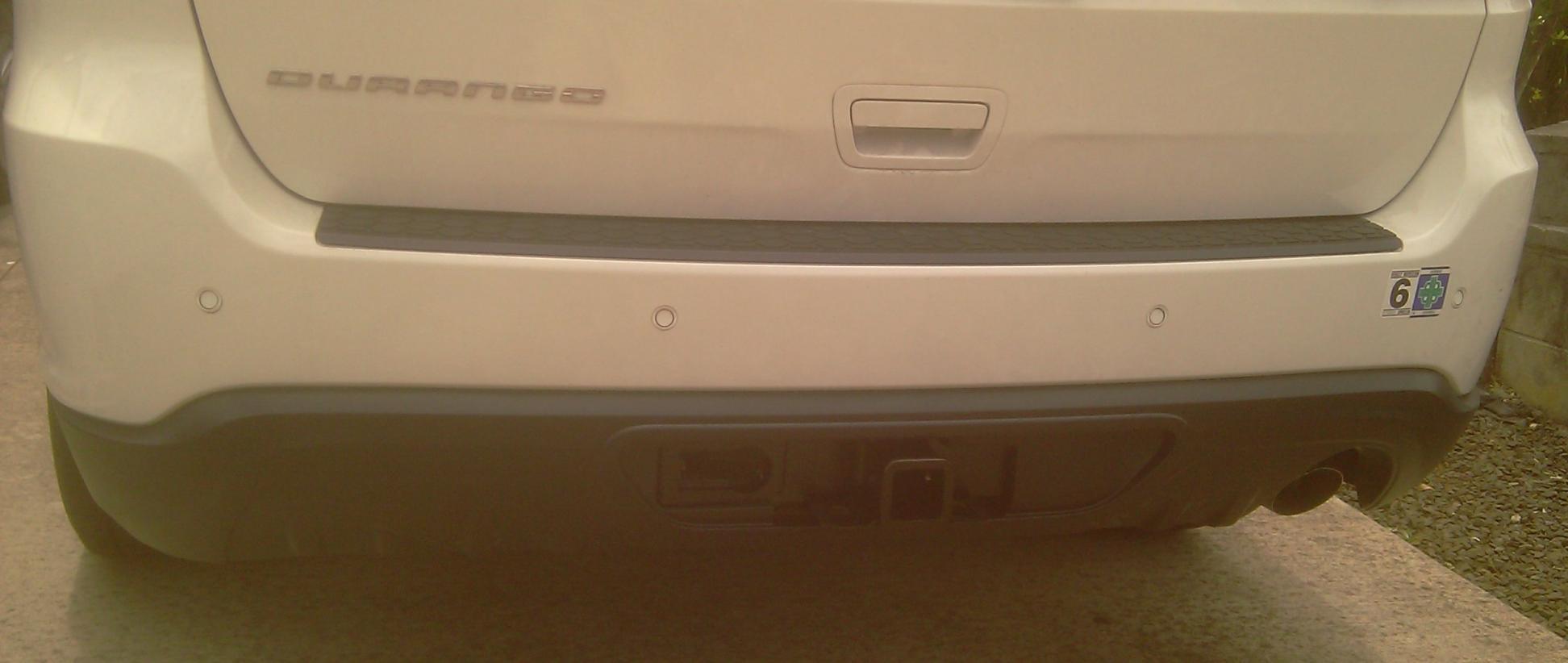

Just installed my hitch on my 2012 sxt. Dealer wants $130 for the activation alone, so I'm going to have them install the harness for not much more. The installation was a breeze. Removal of the bumper gave me the most grief. There are clips that hold the bumper skin to the body that are easy to break. All I need now is to find a full size spare.
