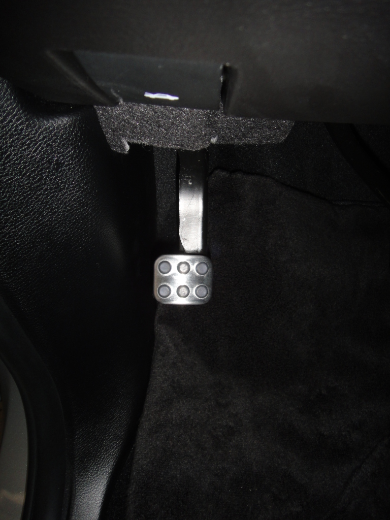

What Do you Think. Working On a (DIY) Modification is Required to Pedal Pad not Pedal. Write up will provide Part Number , detailed modification and pics to match the OEM cut out and Special Thanks.
To All: Mopar does not make a OEM E brake pedal for a CHALLENGER, CHARGER or MAGNUM 300.
They are Using a Mercedes Part (A 203-430-00-84 ) and yes it had to be turned sideways and modified for best working fit for the Durango, I plan on adding PISC showing any one that would like to have more info on what I Did, This was trial and error . I am Expecting more parts to show up , so I can provide details of what worked best for me.
Just giving back to the Mopar community.
And i have to give two thumbs up to the boys on challengertalk. where i started my quest!!!!
This mod will set you back about 12-18 bucks + 20 minutes of time.
Thanks
Duane

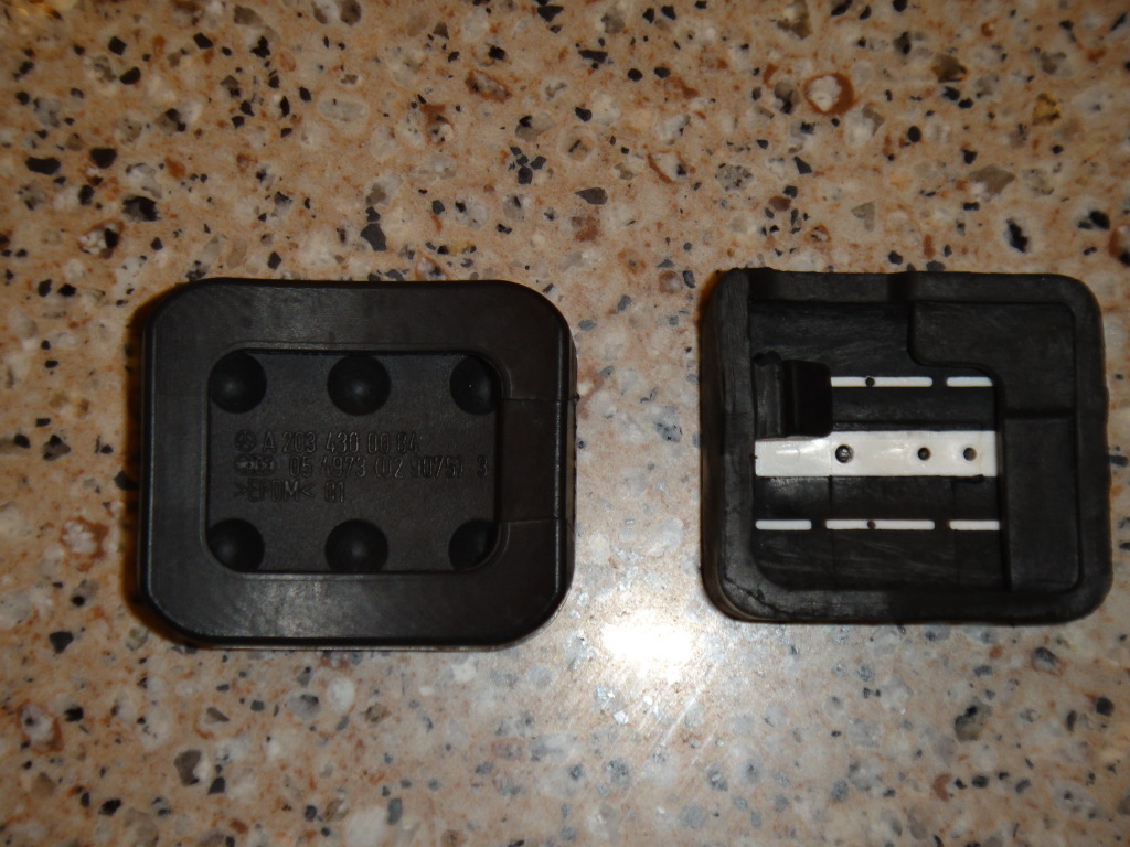

NEW UPDATE 9/5/12
Mercedes Part (A 203-430-00-84 ) and Factory Durango Pads
Factory Cut outs
MODIFIED Mercedes Part (A 203-430-00-84 )CUT OUT LIKE FACTORY DURANGO
MODIFIED SIDE BY SIDE COMPARISON

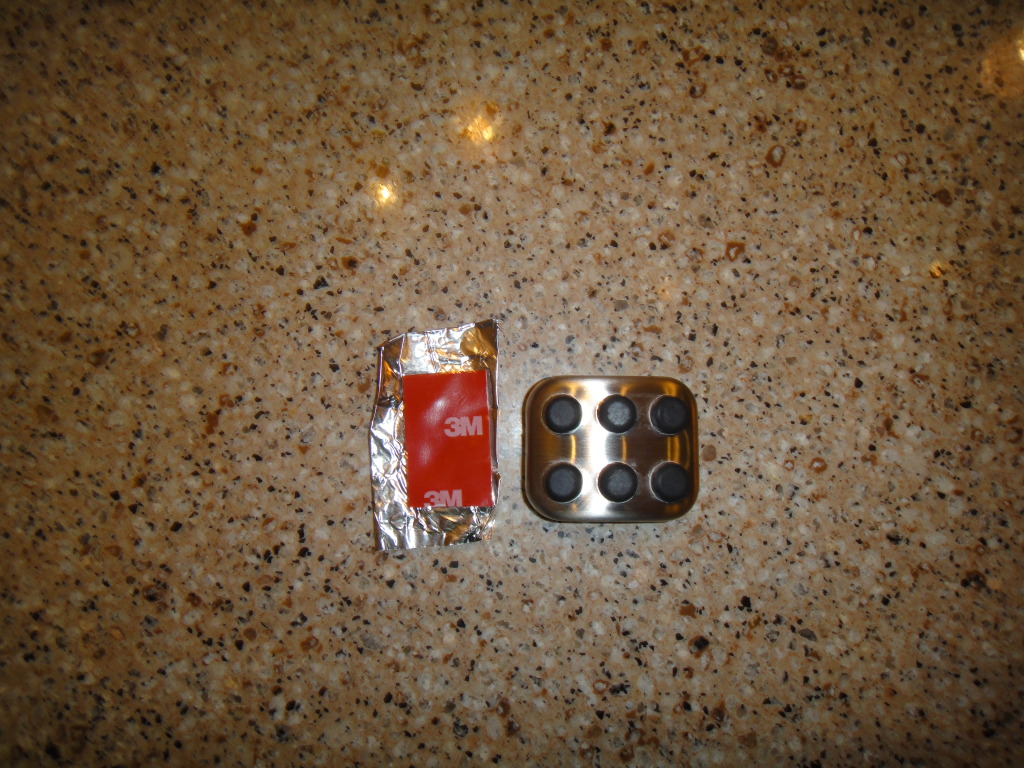

*****RECOMMENDATIONS IS TO ADD SOME 3M TAPE FOR SAFETY AND BETTER HOLD PAD HOLDS WELL WITH OUT IT THIS JUST ADDS BETTER HOLD.*******
ANY QUESTIONS JUST ASK
JUST AN FYI FOR ANY ONE THAT WOULD NOT LIKE TO DIY I CAN MAKE YOU ONE ALREADY MODIFIED, 3M TAPE AND SHIPPED FOR $25 BUCKS .

It looks like the mopar challenger e-brake pedal turned sideways

I've always thought is stupid/short sighted that the official pedal kit was a full part short. Kudos for a working solution while keeping it all in the family.

Nice job!
