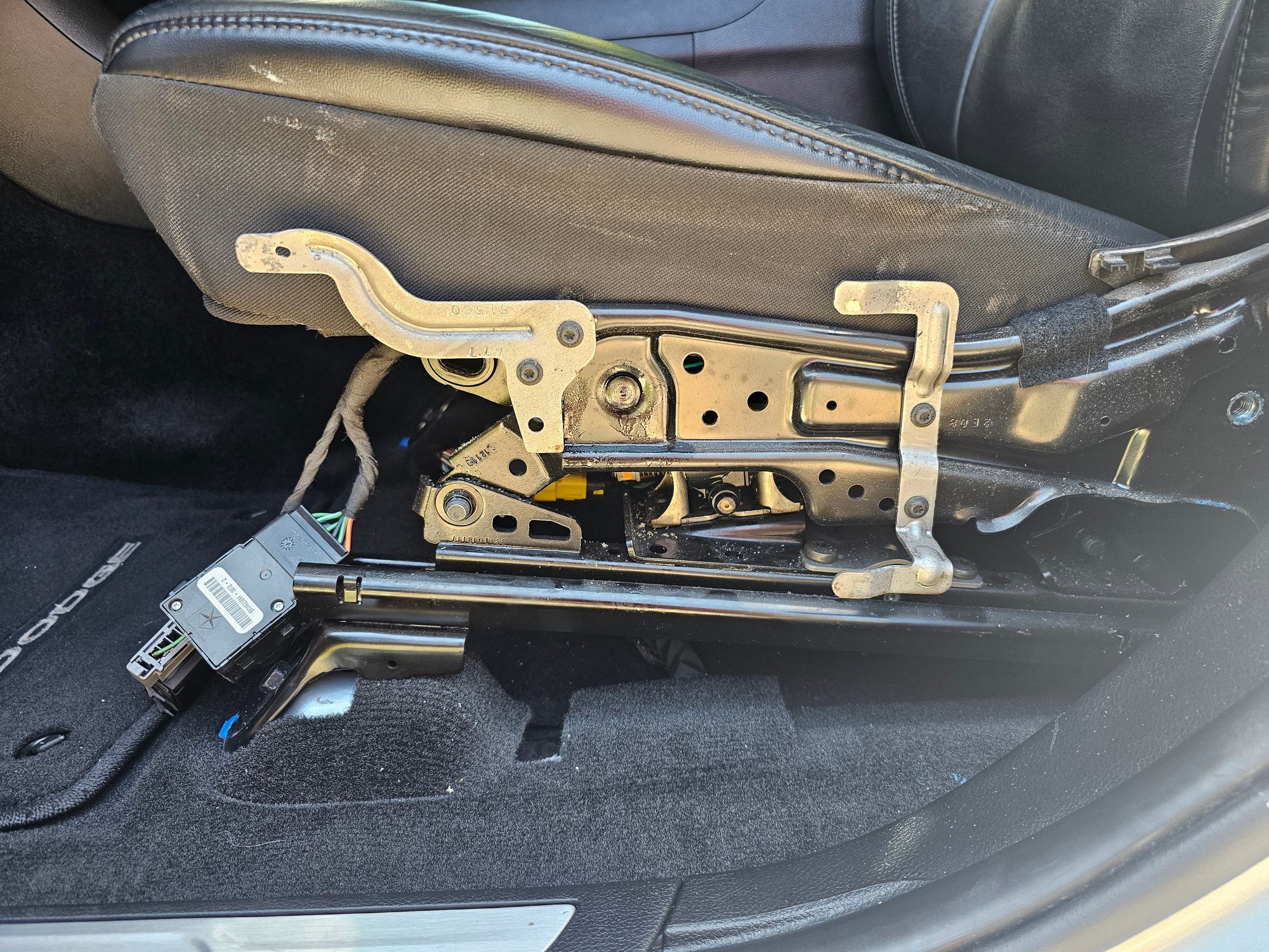

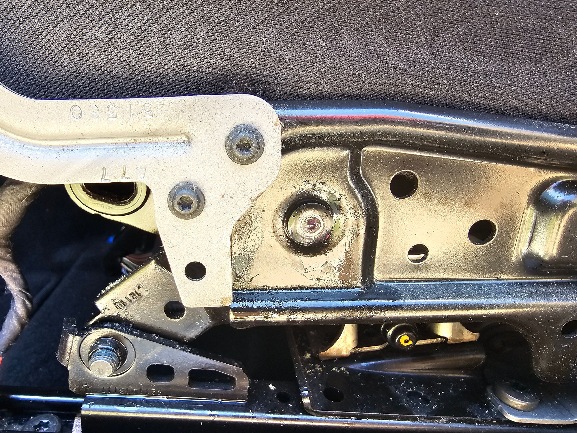

My wife's driver side front seat has been squeaking for a couple of years now. It squeaks when driven on rough roads and when taking corners. I finally had enough. After looking on different forums and YouTube I noticed they all had one thing in common... no solution! Well, here is the solution. I skeletonized the seat (removed all the plastic) and re installed it. Had my wife sit in the seat and shift her weight back and forth, side to side. I used WD-40 silicon spray (not WD_40) and with the straw sprayed each joint on the area where the squeak was coming from. Starting low on the rack and working my way higher so not to have the lube drip to a joint below(there are three in this location) preventing me from determining which joint had the issue. Once I found the exact joint I removed the seat again. Everything on the rack is black except for the nut/s (each side has one). I removed the nut with the captured washer and cleaned all the old lube and rust. I pryed the collar out of the hole that it rides in and applied some high temp ball bearing grease. Replaced the nut, put everything back together, and reinstalled the seat. SQUEAK IS GONE!
