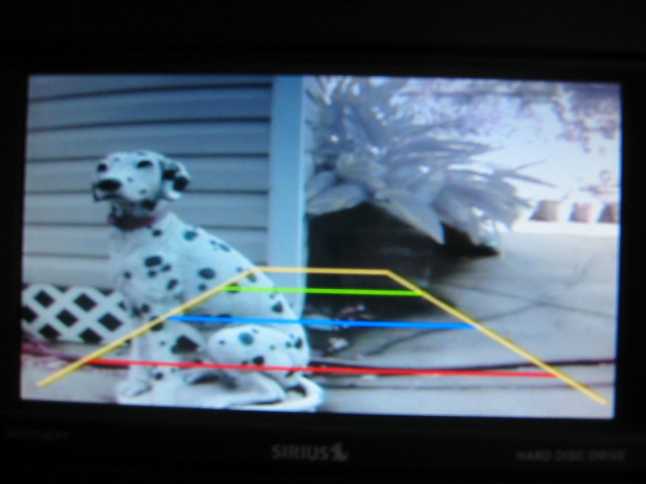

Default wireless camera picture quality
The wireless camera quality is about the same as the Dorango backup camera quality. I rewired the wireless camera to eliminate the wireless transmitter and receiver and found the quality didn't change. The attached pics are worse looking than the actual images on the radio display, but the comparison between the Dodge camera and the wireless camera are accurate.
Ray

Thank you for the comparison views! I have since returned the expensive wired option and purchased the wireless one on eBay.
