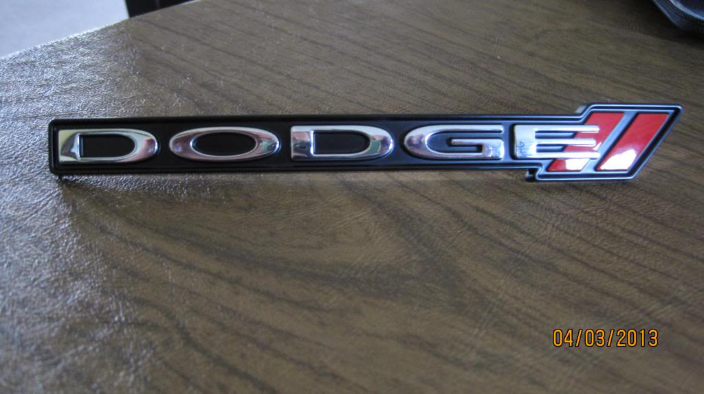

FiremanPrice, here are some photos:
1) the front of the emblem.

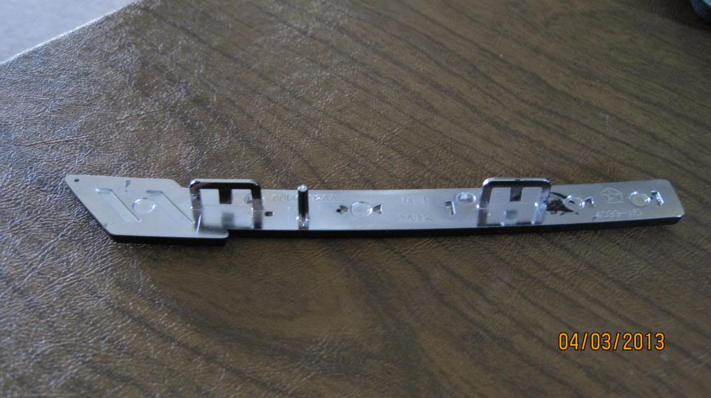

2) the back of the emblem.

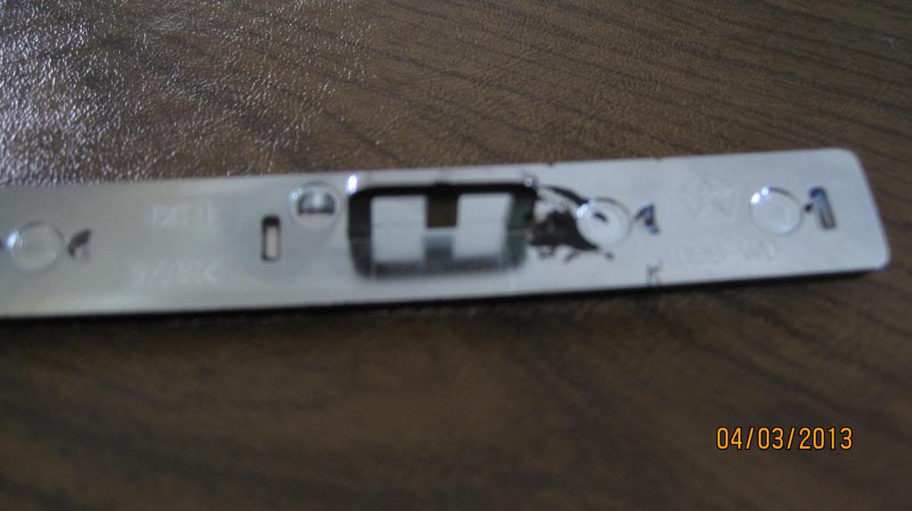

3) One of the two locking tabs

You need to go thru the honeycomb from the bottom of the emblem and push slightly up on the tab to release it while gently pulling on the emblem outward. once I got the first one out I pulled alittle bit and it popped right out. I used a 90* hook tool from craftsman, worked like a charm. I also looked thru the hood hatch area to see down to the emblem instead of trying to do it by feel alone. good luck

Glad I could help Mr. Price. Just be gently they break easy. You only need to push up on the center portion of the tab, its like 2mm up and it will unlatch. I tried taking a photo of the center tab portion but it just wouldn't come out.

Ok, so from the center of the tab gently pull upwards and out. Gotcha, thanx again. I will leave up when I get it in.
