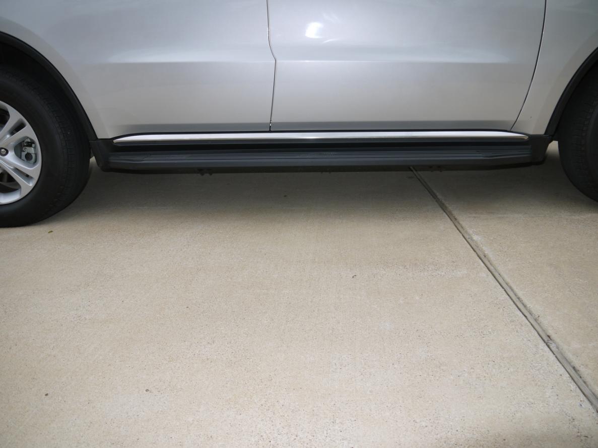

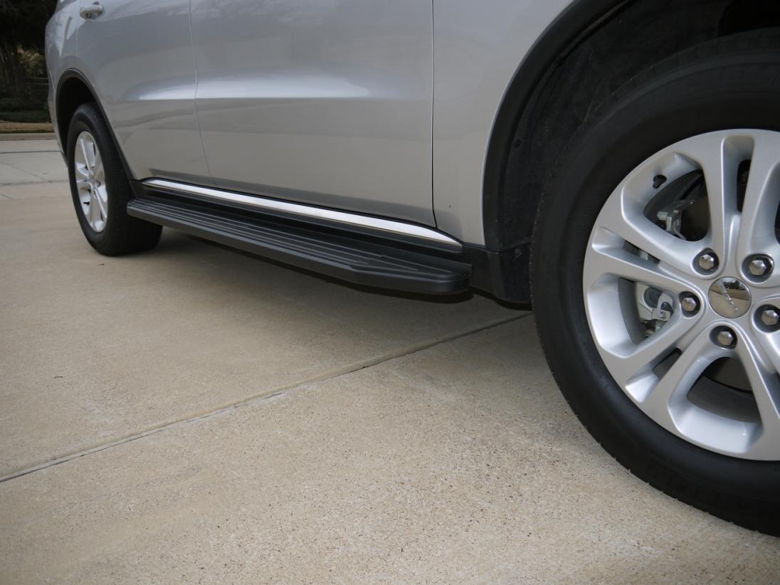

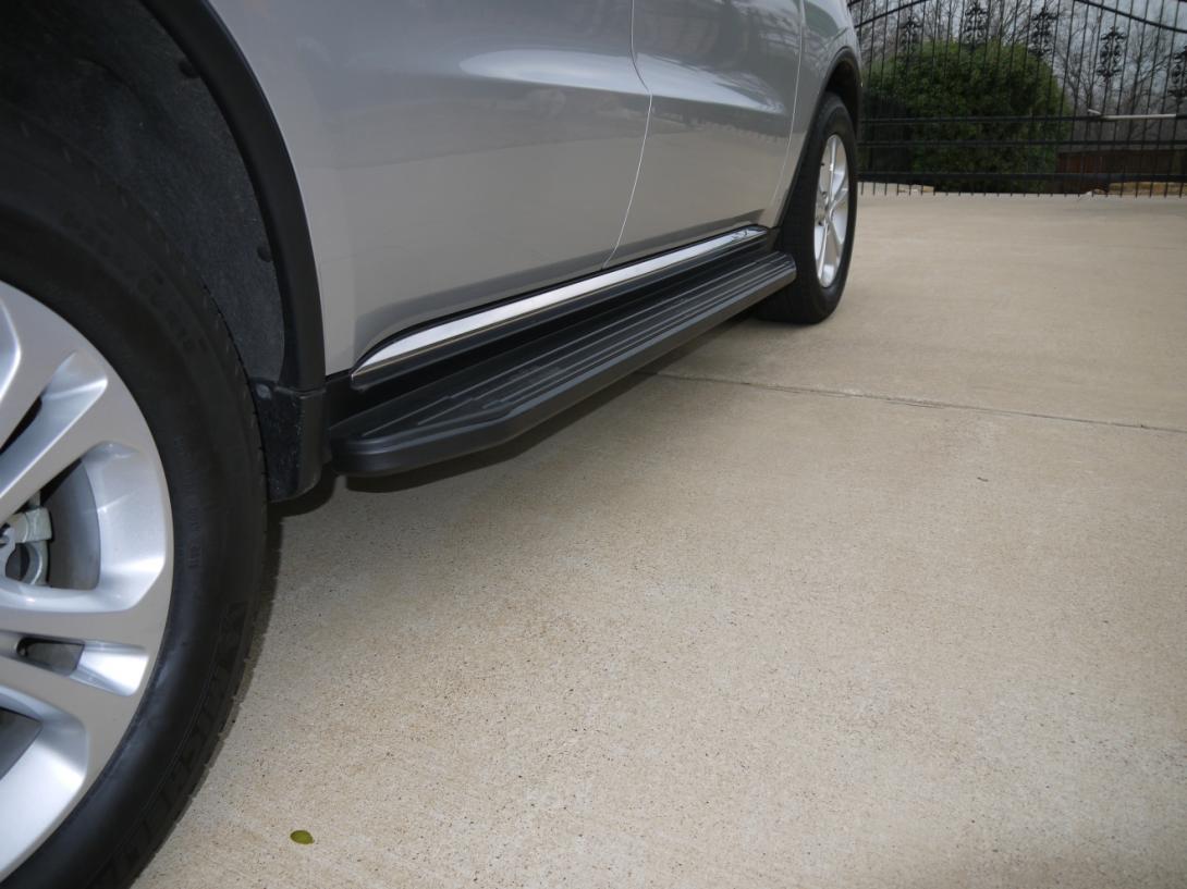

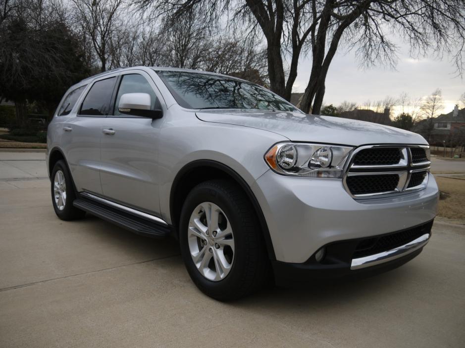

Default Added Running Boards
I looked into running boards for my wife's 2012 Crew.
Didn't want nerf bars and managed to find some on eBay for fairly cheap, about $225.
She didn't like the chrome outside edge of them, so I Plasti-dipped that part black.
Had to remove and replace the cladding to get them to fit, bent a spot here and there trying to remove them , but finally got them on and got the cladding back in place.
Otherwise, the running boards used the existing holes underneath.
You'll want a deep socket in order to tighten them up right.
Craig

1. Yep, had to remove the cladding in order to get the bracket in place, installed the brackets, then replaced the cladding.
2. The cladding does NOT interfere with the brackets that came with my running boards. (when I first got my running boards, I thought I was screwed and gotten the wrong set because I couldn't get the brackets in place until I realized that the cladding was in the way) However, once my brackets were installed, the cladding was easily replaced and doesn't interfere with the brackets or running boards at all.
3. The brackets snap on with these push in type pins, trying to get them out of the mounting hole I bent a few and roughed up the edge of the cladding trying to lever them out. Plus, the are held in by a different type of push in pin in the wheel wheel and a bolt (I'm trying to remember from memory, so little fuzzy on the details, should've taken pics of the process, sorry didn't think about it at the time). Also remember having to take off the rear wheels, in order to have enough room to work on the pins in the wheel well since the cladding goes from end to end.
The damage isn't really obvious. (if I get some free time, will try to take a close up pic of the "damage" it really isn't too noticeable, sorry work pretty busy so don't have a huge amount of free time)
4. I can't tell you about the other kits, but I suspect all of them will require you to remove the cladding....it is in the exact "wrong" place when trying to fit the brackets into their proper location.

my plan was to buy a replacement cladding set if I really f'd them up, but I got lucky and managed to pull them off without too much damage.
take your time with the cladding and lever them off slowly... I used tools from a plastic trim/car radio removal kit I got off Fleabay for $5 (can also get them cheap from Harbor Freight too). prolly would've caused more damage using a screwdriver or butter knife, etc...
