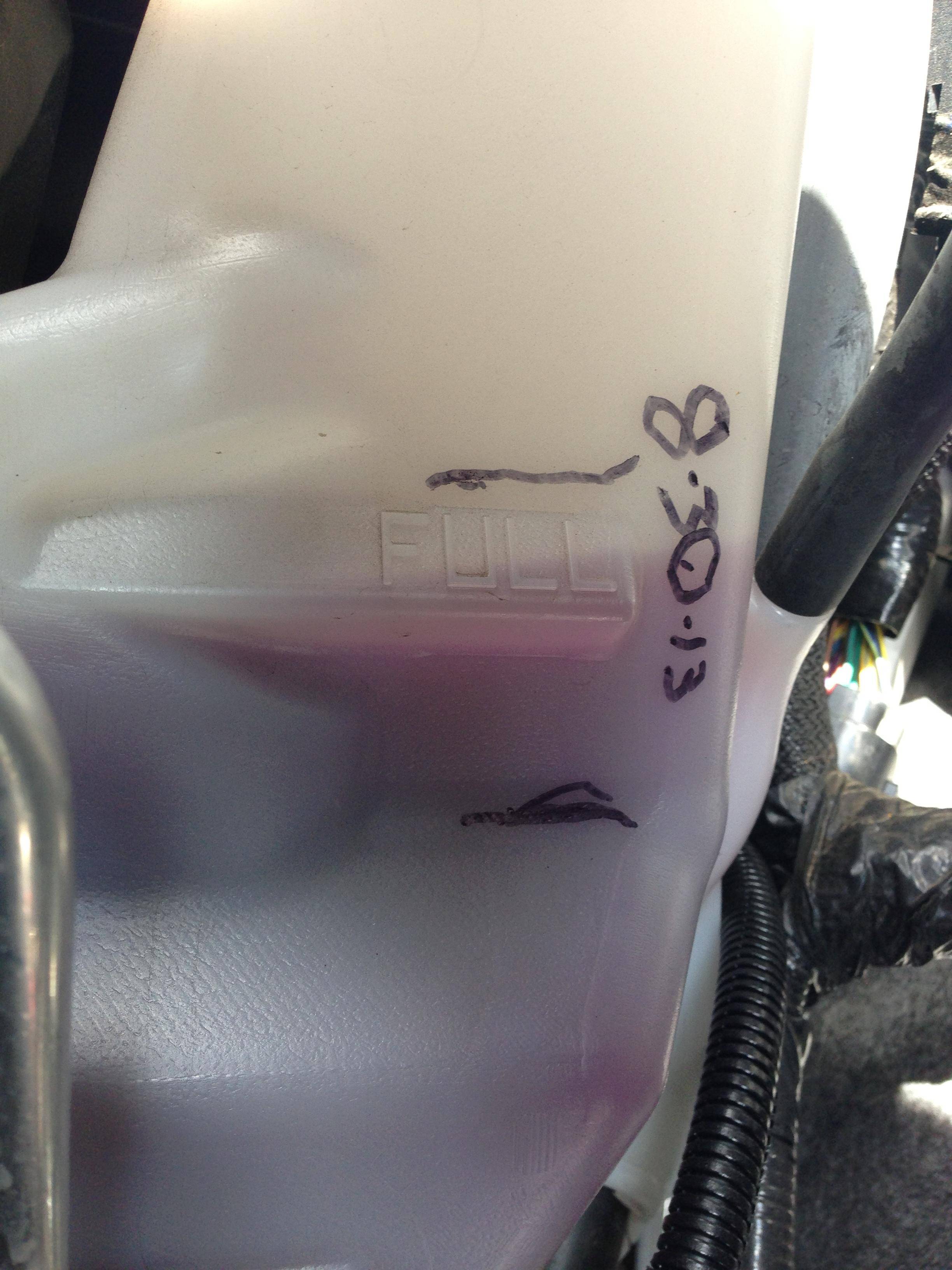

As you can tell, I am parked on a hill, but this is the level change in 300 miles since 08/30/13.

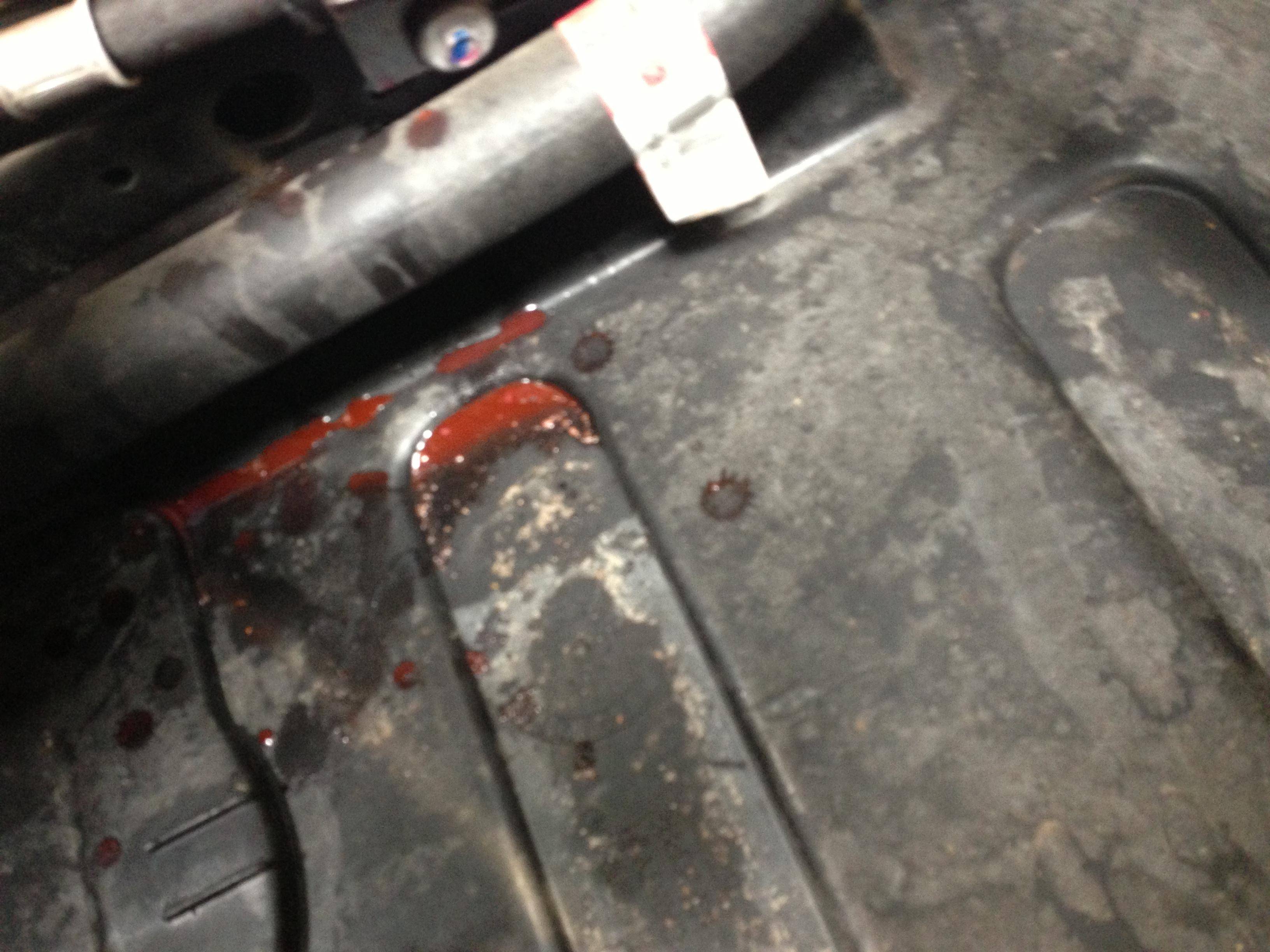

This is below the engine today:

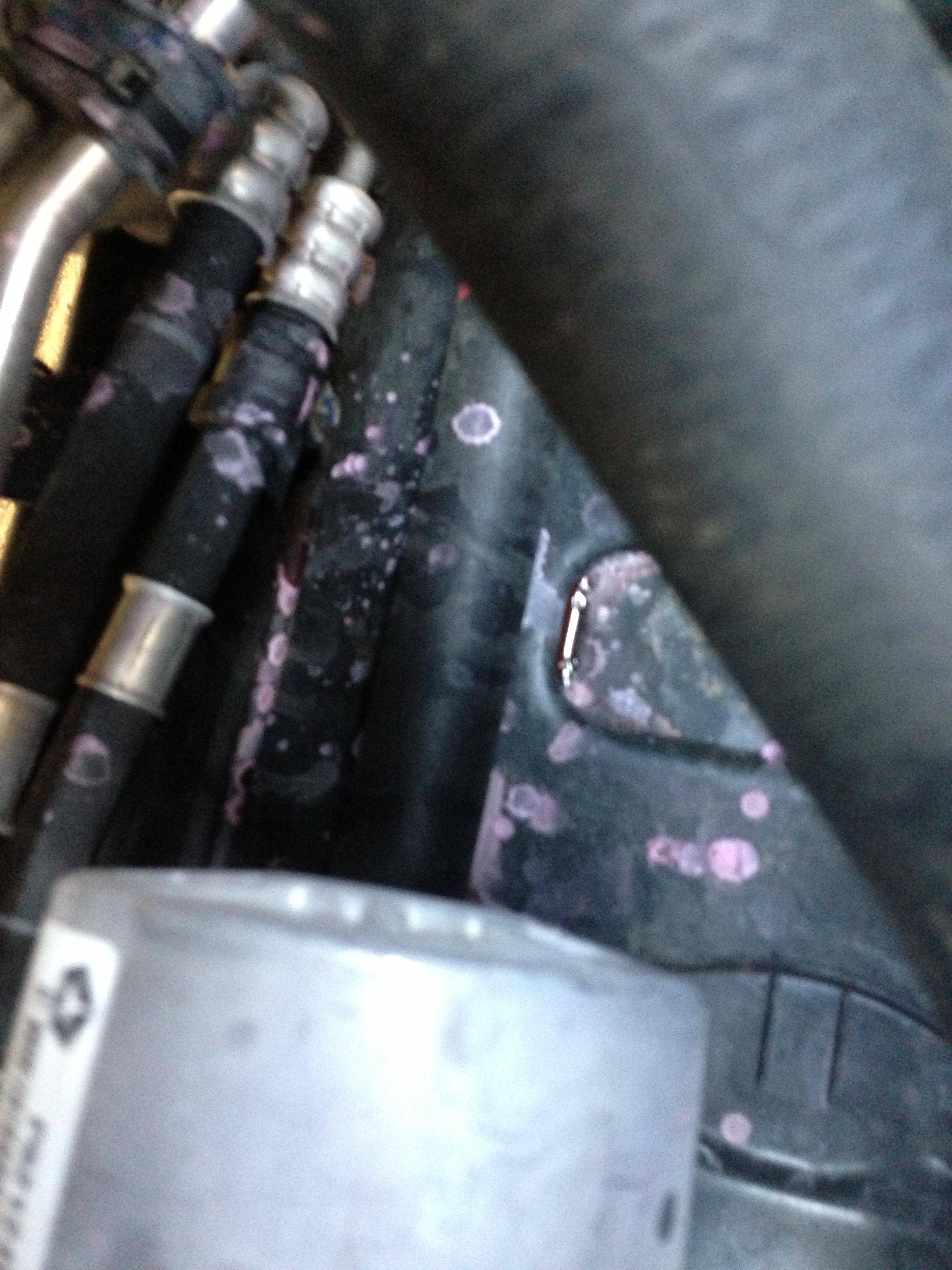

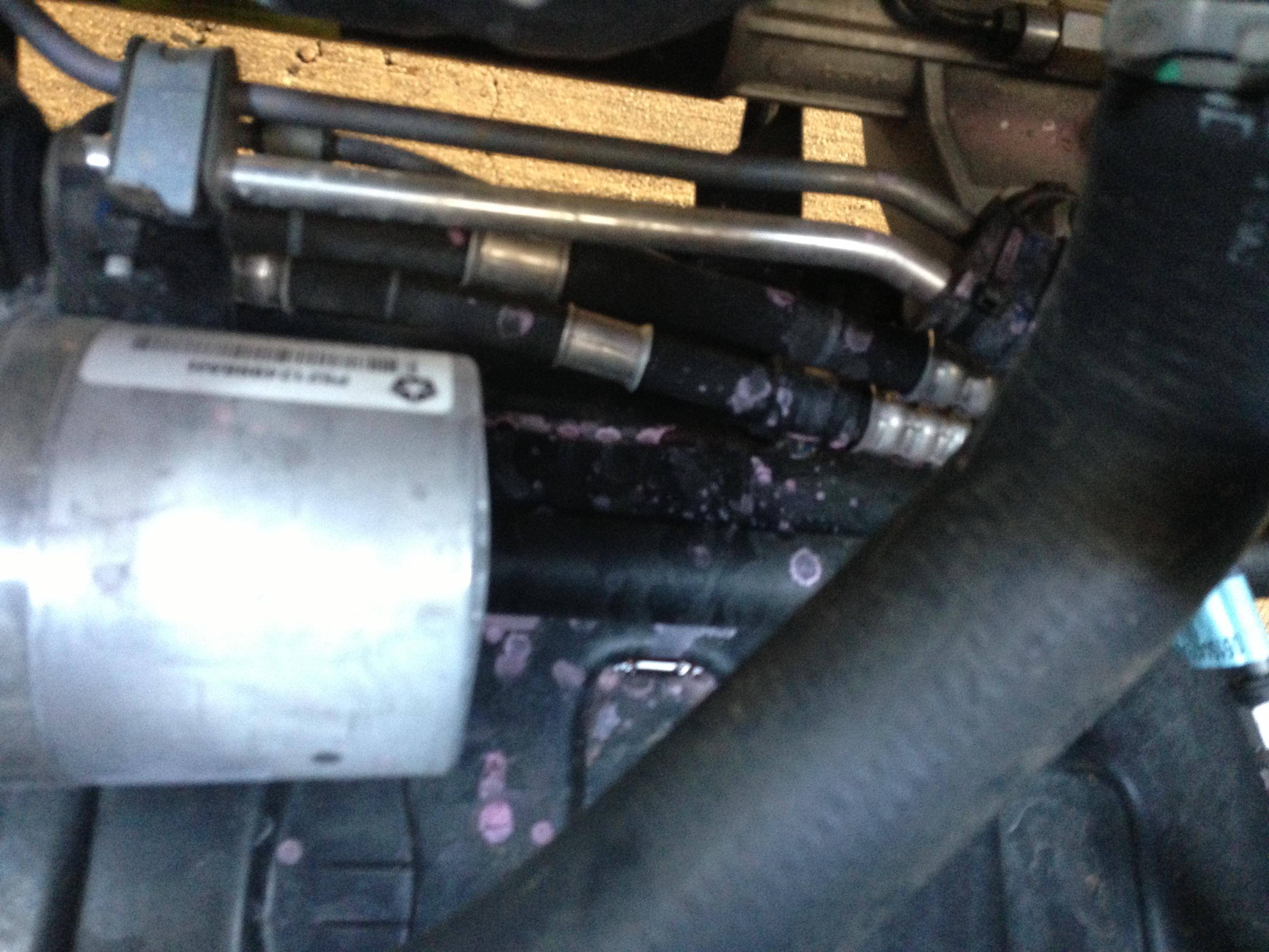

This was before the rain wiped out the existing coolant:

Sounds to me like a poorly installed cylinder head with a bad or damaged gasket. The coolant leaking from the head could have damage a cylinder and/or cylinder ring which now is now allowing large amounts of fuel to seep into your oil. I can't be certain since I don't have your truck in front of me, but given what you've described that's where I'd look next.
And don't assume all the coolant you're dumping is coming leaking out. In the mean time I'd keep an eye on the consistency of my oil if I were you. If it starts to get frothy you may be getting coolant in the crankcase as well.
