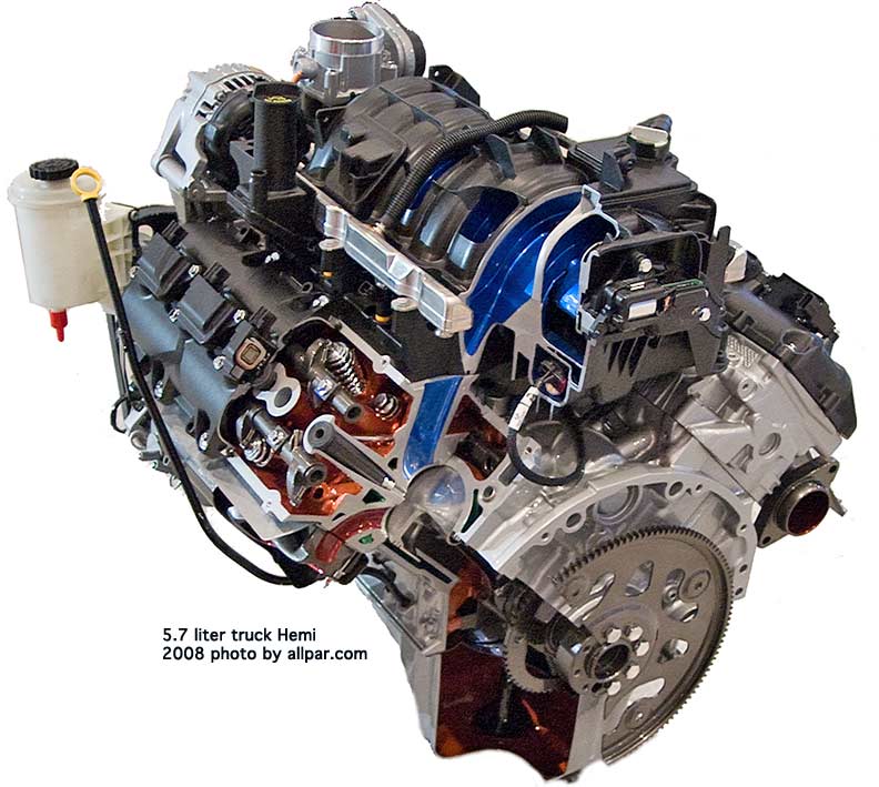

[QUOTE=plib;3092179]I was wondering if the new 2014 Durango with hemi has or not variable intake lenght.
No it doesn't, the engine is identical for 11-14' models. Tuning for the 8 speed transmission and axle ratio are the only drivetrain changes. Do a search for RAM INTAKE ON DURANGO. Its been covered a few times. Packaging is the problem, The rams intake manifold is different and points the Throttle Body upward Name:  truck-hemi_zpscf04322d.jpg

[QUOTE=Fullslp;3092473]
Thank you!
So this is the reason for the hp difference?
I was thinking to buy the 2014 rt version but I love too much my old 2009 and when there is the change in intake it seems a turbo is kicking in. Plus I paid it 26000$ and the new rt seems priced around 40000$! The new transmission alone is not worth for me
