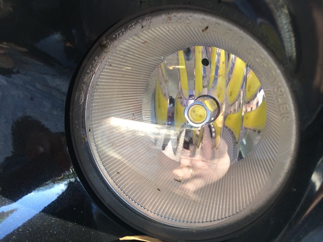

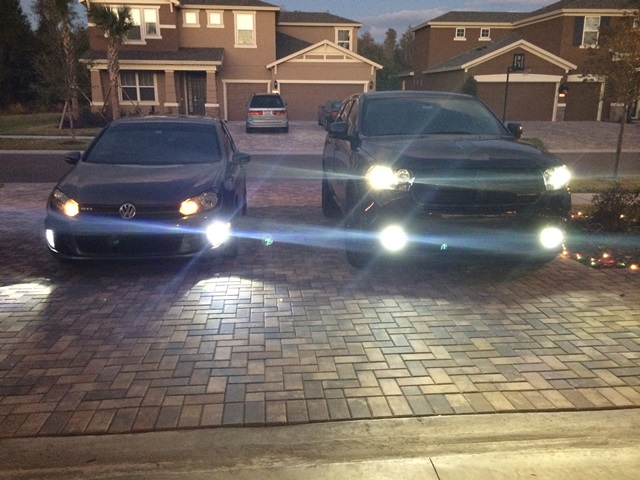

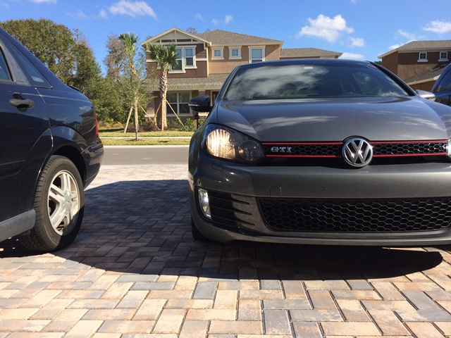

ok, got mine installed over the weekend... I had to shave off a few tabs, but install was easy beyond that... I think they look good, albeit not a perfect match to the HID's, but definitely better than the 6k's I have in my GTI... I know... Pics or it didn't happen... Here ya go:

Here's the 6k's in my GTI

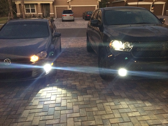

At dusk (sorry about the glare from my iPhone)

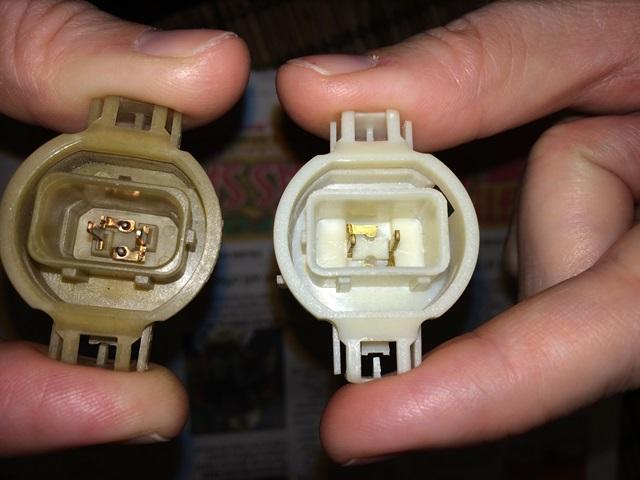

bulbs side-by-side (you can see the tabs around the outer diameter that have to be cut off)...

But I also shaved off the tabs on the inside (you can see the differences)

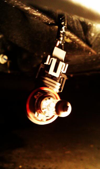

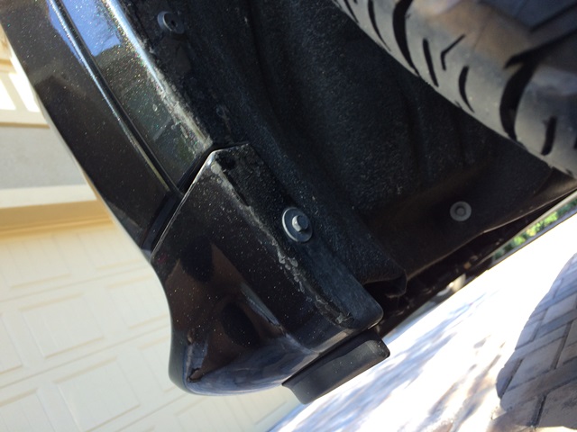

And for those instead, yes, you just have to crawl underneath the front bumper and pull the splashguard out of the way to get to them... And for reference, to get the bulbs out, you have to squeeze in on the 2 tabs on the sides of the bulb. Took me a minute to figure that part out...

Glad you like them, they look great. They are as close as you are going to get with LED's to the factory HID's.
