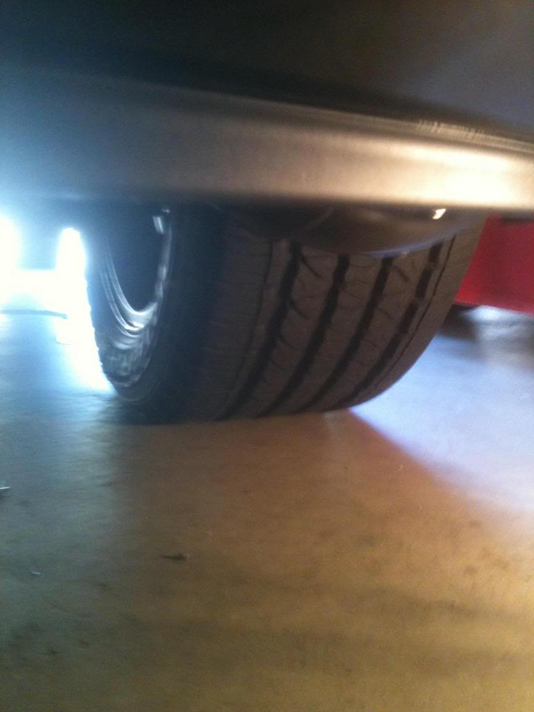

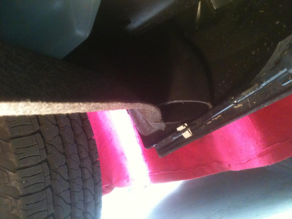

These are crappy cell pics sorry but you get the idea. I used zip ties to hold it in place then glued the sections together and used aluminum bands to mount them to the chassis.
This is a tight fit for a 3 inch and slightly bulges the inner fender lining toward the tire. no interference though.
this is all you see from under the front end

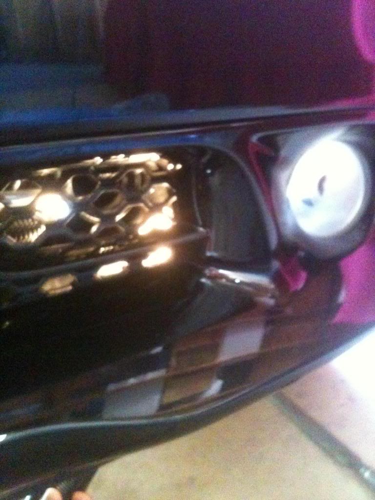

here is where the outside air enters

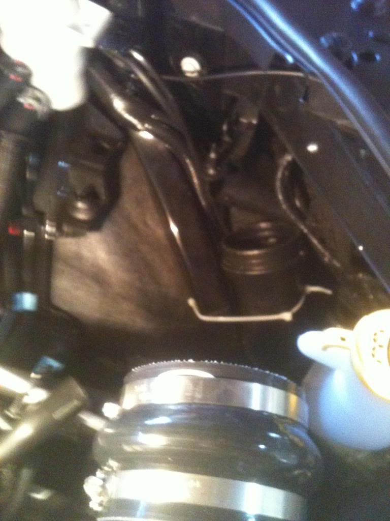

the down pipe before fitmentName:  IMG_1606_zpsa4949273.jpg

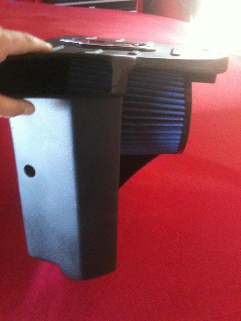

the open area of the Volant is hidden in the fender where your 3 inch feeds it

My IATs are significantly lower (tested and info in the thread "some under hood temps") and because of the Volant box design this setup creates a high pressure zone in the Volant box at speed. Consists of a 27 inch downpipe, (3) elbows and a 4 inch pipe section. If I did it again I would go with 2 1/2 inch piping for an easier fitment. Cost about 20 bucks to make and its *******ly invisible.

Yep. The pathway for air coming through the stock location is both small and much hotter coming off the radiator. This draws cooler air from the lower fog lamp area
