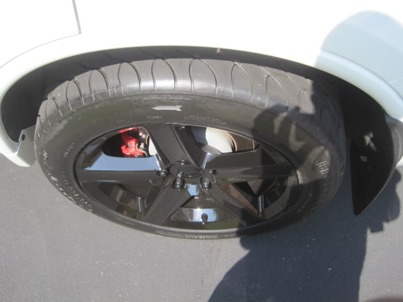

That is an issue with the Nittos. I was looking at those originally, but the place where I bought the tires/wheels said I was going to be much happier with the BFGoodrich G-Force TA. I love them. They are more expensive, but it's the only thing between you and the road. I never skimp on a tire.
And they look killer. I went with a 295 45 20 on 20 x 10 in the rear, and 265 50 20 on 20 x 9 in the front. With the towing I do, I wanted to stay in the 20" wheel, it still looks fantastic.
