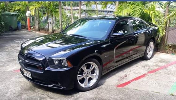

Joined: Jun 2018
Posts: 5
Default It’s all good...still a Mopar guy!
