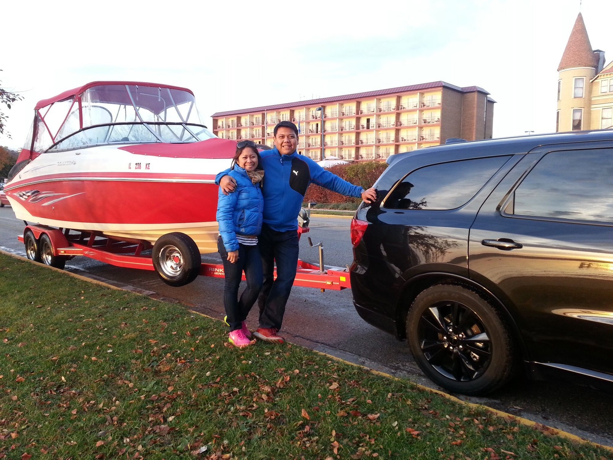

Hi, we tow our 6500 lbs, 26 foot boat and trailer with our 13 RT AWD. It has plenty of power and tows really well. Only complain I have is that the load leveling suspension takes a while to adjust. It took some getting used to coming from a navigator with auto adjust air suspension.
We are very happy with our DD RT. I posted a few launching and retrieving videos on you tube that you can check out. You can search Rinker 246 on you tube.
Thank you! I checked out the videos. I does look to pull that big boat out with no drama. I was watching the 4 minute long video where you were launching it. To me, the rear end still looked like it was sagging. If that is Dodges idea of load leveling, They should not be advertising it as such. That does not look leveled to me. Maybe that was an anomoly?
Anyone else have any feedback?
I still want the Durango but the lack of proper load leveling might be a deal breaker for the RT...that is pretty dissapointing. But hell, its the RT I want so that might be a deal breaker for the Durango period....I'm going to start looking for an air bag system that might work for the Durango. I'd be willing to put about a grand it if I can find a good one.

That video was a table rock lake. Like I mentioned the RT takes a few miles to load level. When we launched we just came down from the our condos boat parking area after hooking up the trailer. It's only a few meters away from the boat ramp so the RT's load level has not fully pumped up to its normal ride height. That's why you see it sagging in that video.
If you read the nivomat load leveling instructions I says it takes about 2 miles for it to load level.
I tow a couple times every summer about 450 miles each way and never had issues we the rear suspension. We usually go to table rock lake or torch lake and there are lots of hills to climb and many miles of mountain roads.
