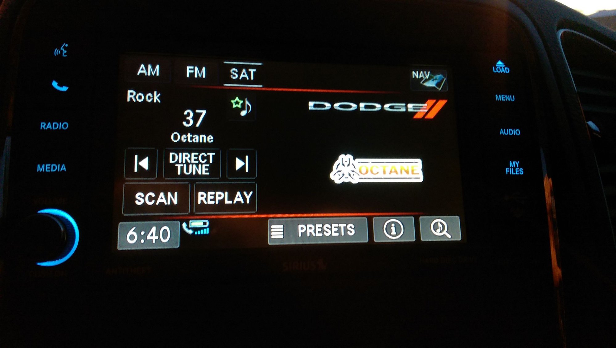

I updated my 430 RBZ over the weekend! It was easy...just make sure you go to 33.xx.xx before you got to 50.00.07!!
I keep the motor running during the updates and had zero issues!
I got the downloads from here...
http://mygig-disk.com/download-rbz.php (see MyGig Updates half way down the page)
I also added a custom home screen image to complete the new look!
Sorry for the crappy pic...I'll get some better photos once the weather calms down!

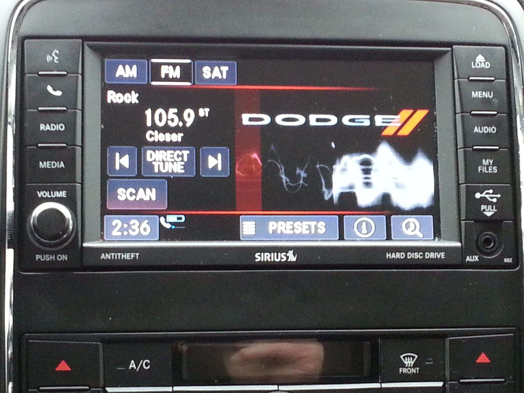

What is the model code on your radio? Should be on the bottom right corner under the aux port.
You should have an RER or RHR sales code...2.126 should be an RHR so check this page out:
http://mygig-disk.com/download-rhr.php
Your instructions and downloads are about half way down the page under MyGig Updates. The trick is to use the Express Burn software to burn the iso files on to your disc's. You can't just move them to the disc as a file, they need to be burned in iso format! The page I linked above has a link for Express Burn as well...it's a free trial and completely safe. I just went through this last weekend and had no problems!
Also, if it isn't clear, be sure to burn the iso's on 2 different discs and label them. You must update the radio in steps! You can't just update to the latest software, it will brick your system!
