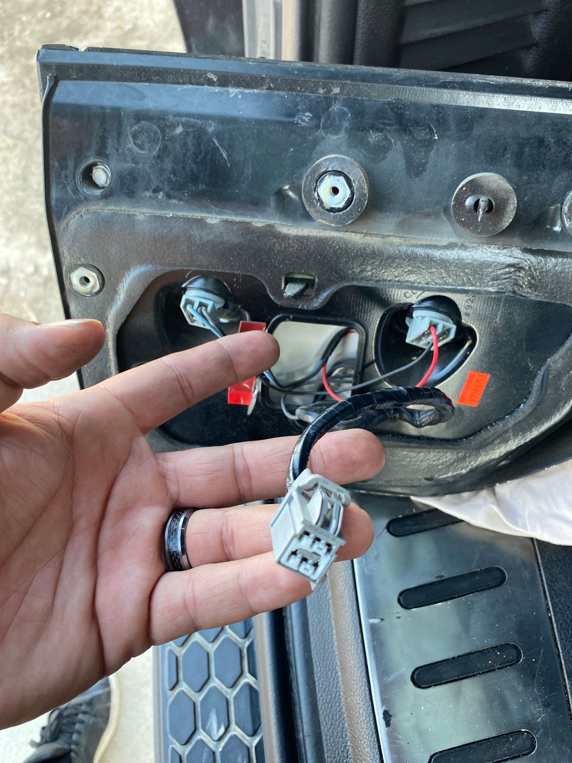

do you have a diagram for the center tail light ??

Default Center tail light wiring
Originally Posted by durangomty
there are two connectors on each side, one is used for the reverse, ground and live....the second connector has three wires for the tailights, ground, stop and directionals I used a tester in order to know which wire does what, then I used a 9v battery to check which wire does what , see attached wiring.. hope will help..
led tailight wiring..
do you also have the center tail light wiring diagram ??
And where do you get the resistor ???
