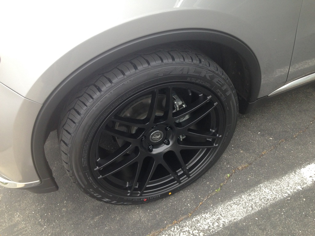

I finally got a chance to get my Forgestar F14's installed. The fitment is exactly what I wanted: flush with the fenders front and rear.
I've been driving on them and noticed no rubbing, even at full lock.
Here are the specs:
Forgestar F14
22x10.5 Deep Concave front
22x10.5 Deep Concave rear
+45 offset front and rear
Falken Ziex S/TZ05 tires
285/40/22
I hope this helps others that want to run these sizes.

Rotate those tires often. I had the STZ04's and they did not last long at all! Wheels look good.
