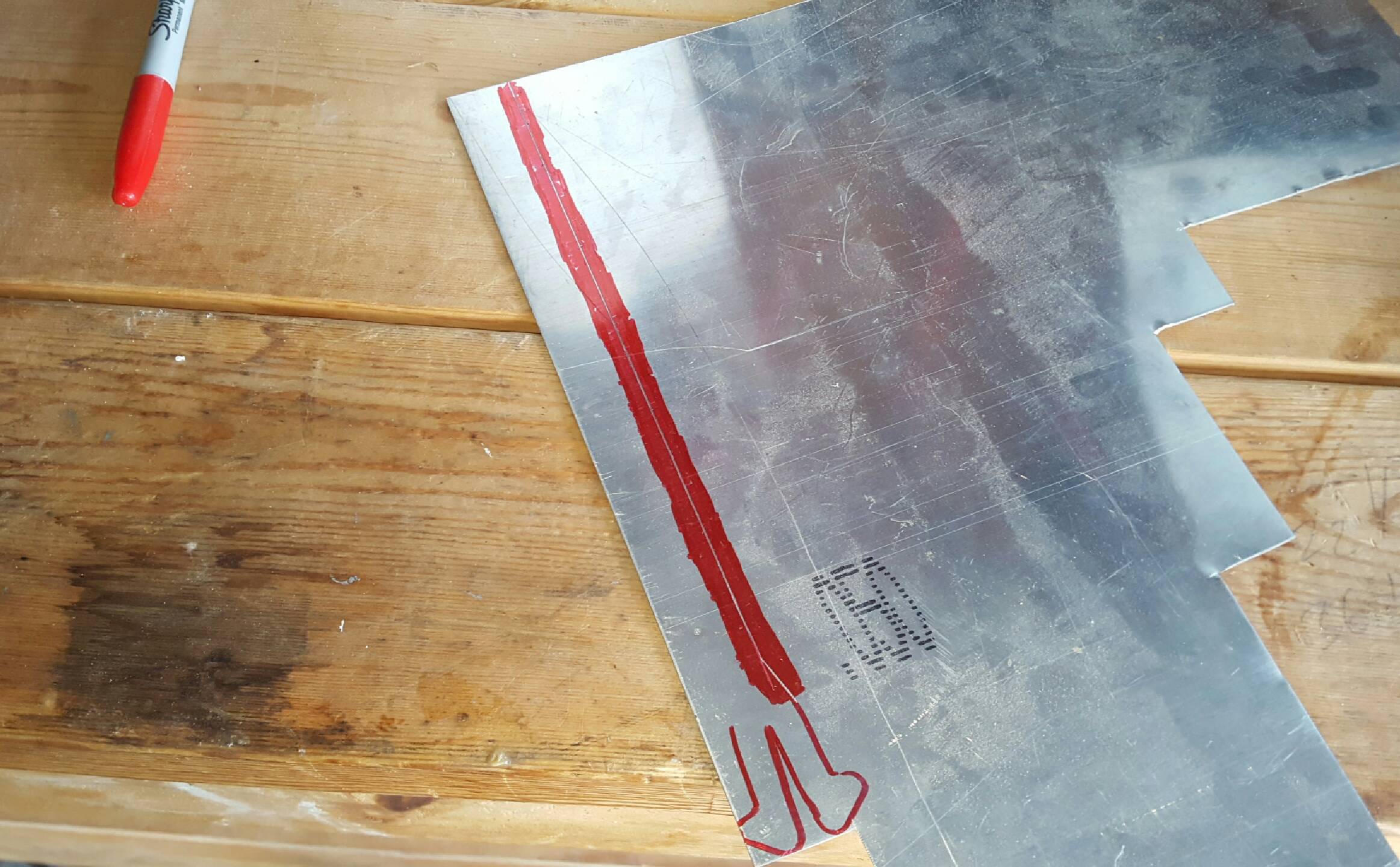

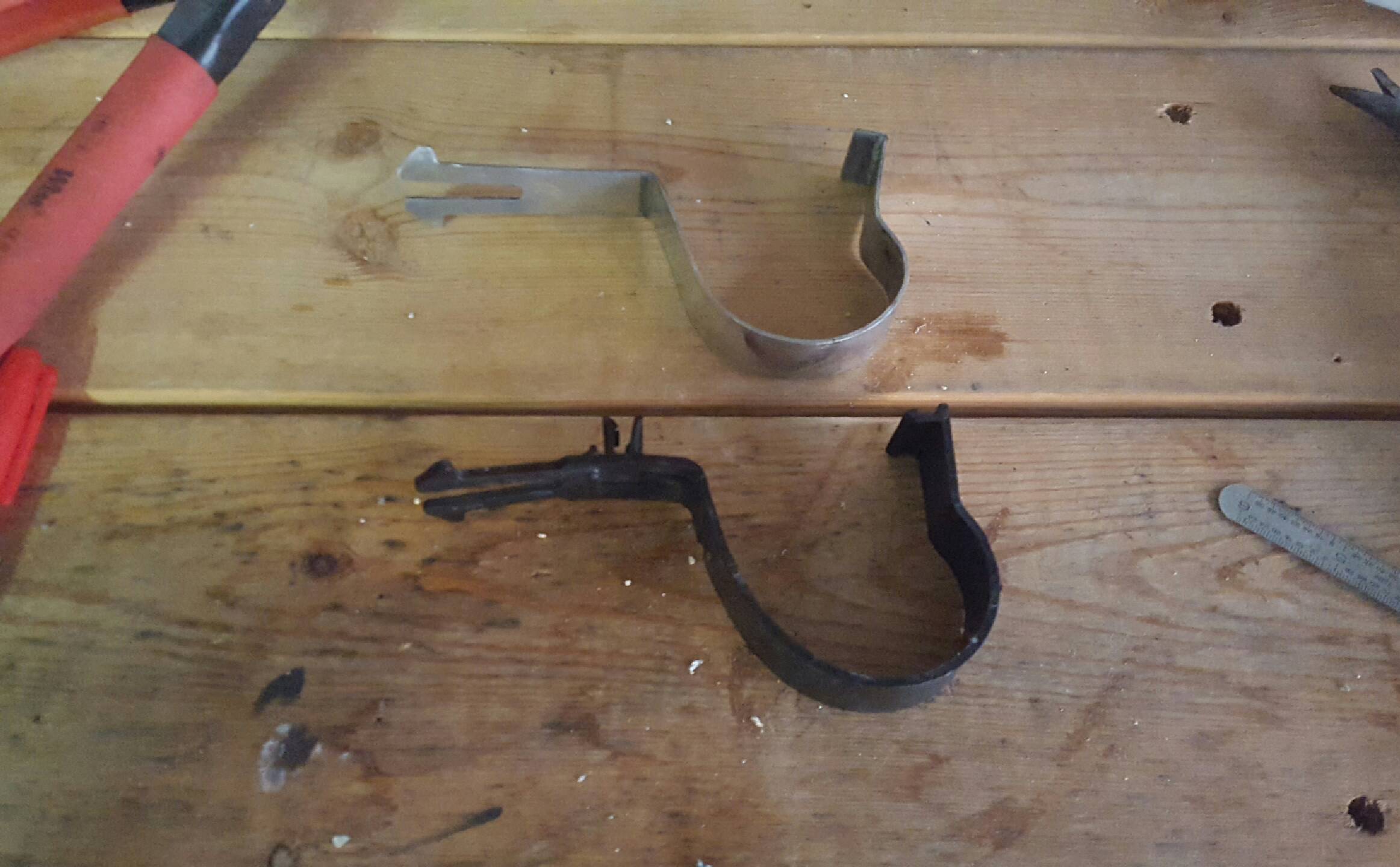

So, many moons ago when the Gen 3 D came out I remember a guy saying that the plastic clip holding his upper radiator hose was worn through from the fan, then the fan chewed through his upper hose and left him on the side of the road. A few weeks ago I noticed a tick tick tick noise on my 2011, did not last to long and it went away. I blew it off but I have heard it a couple times since then. I located the noise today. When the vehicle is first started the electric fan starts slow, then will build up speed. It seems that at the low speed the back of one of the fan blades hits the clip holding the upper radiator hose. As the fan speeds up it goes away. I am guessing it is from, what we in the prop plane world call thrust bending. The fan actually bending forward as it speeds up and is moving more air, when it speeds up it clears the clip. Over the years it has taken a toll on the plastic clip, glad I checked it out when I did! I have attached pics of what I am talking about and my reworking of said part, it might be worth 15 minutes of your time to check yours!

Mine is a 2011 R/T. It is the same clamp, I just do not have the part top that clips in to the bottom part of the clamp shown in the pictures. The issue may occur after the plastic "sags" over time. Mine did not fall down into the fan, it just looks like the weight of the hose over time caused the clamp to keep sagging down until it was rubbing against the blades.

Maybe I found a new aftermarket sales opportunity! Coldsteel, glad it happened in your driveway at least. I am interested to see what you find. I did check with Mother Mopar a while back, it does not seem you can buy just the clip.. It appears it comes with the upper hose, even at that it was only around $28.00 IIRC.
