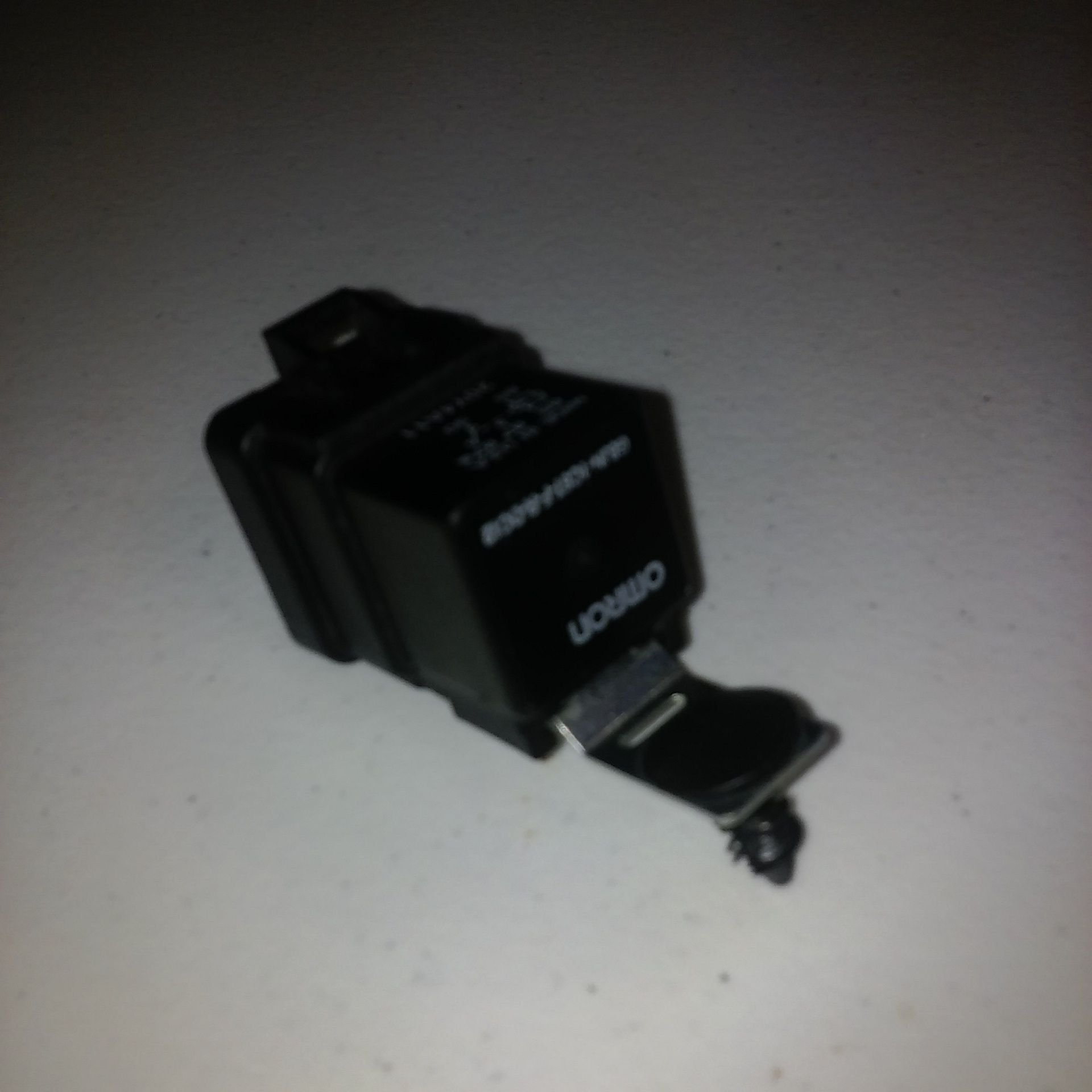

Default It was installed by the dealer
This is the relay before I took it apart.
Thanks; that's the one I expected to see. I'll definitely order one and keep it in the vehicle.
I wonder if the location under the hood, exposed to temperature extremes is causing premature degradation.
The high current contact shows signs of significant arcing, like it isn't closing fast enough.
