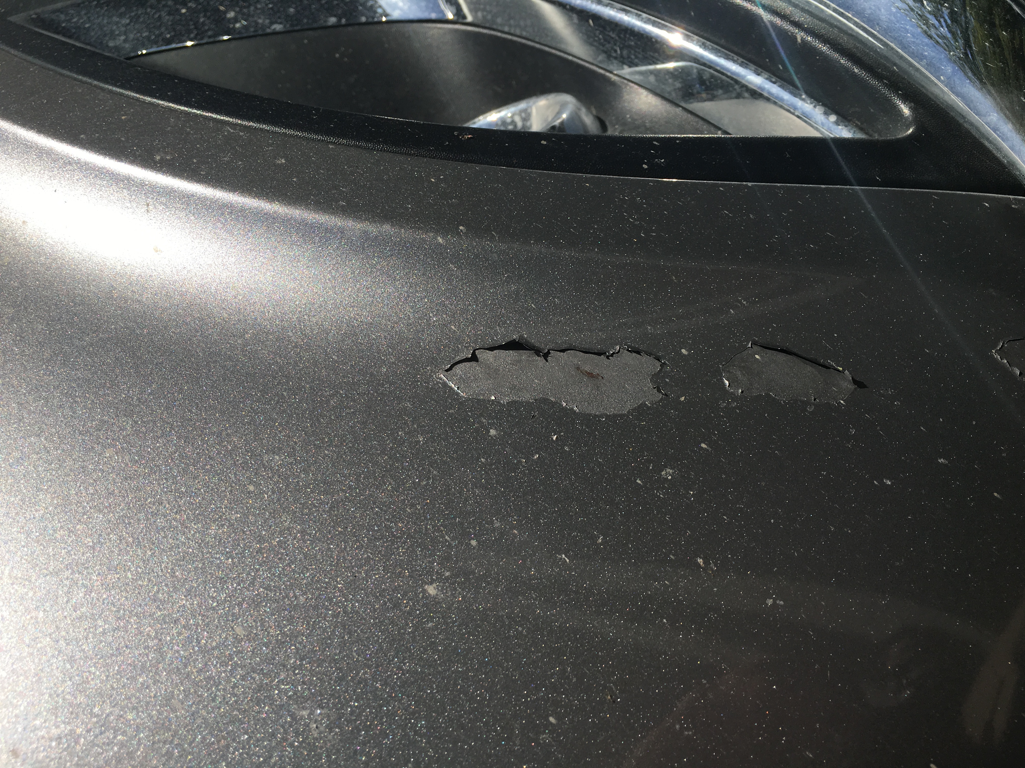

Here are some pics. What's your thoughts?

I by no means am trying to take advantage of the manufacturer. If I caused this issue I would repair it on my dime. My wife and I sit very well financially so by no means am I trying to come across as a crybaby regarding this. The answer I have received from them is this is "road chips". Hmm, this sure doesn't look like chips to me. In my world this is straight peeling! Another comment I heard was it looks like the vehicle has been damaged by the way the bumper doesn't alight to the metal fender. Hmmm. Maybe I should snap other pictures of body alignment. Fit and finish on American cars are still worlds away from European vehicles. My 2016 Dart hood dips below the bumper line on one side and is raised above it on the other side. Anyways, please feel free to share your thoughts on this issue. The saga continues. I will post as it progresses. Very troubling to have a new vehicle with this type of issue and nobody home at the dealership level to talk with about it. I guess a warranty is truly not a warranty. I wish they would stop sending me those requests for extended warranties and lifetime warranties! They should do stand up. Got a vehicle under a year old with under 10k miles and it apparently doesn't have a promised warranty as it stands!

If I walked up to a random car and saw that, I would assume it had been painted by a terrible body shop. I do a TON of work for "swanky" used car lots who Frankenstein cars together and I see plenty of bad paint jobs. Those are not road chips or flex/rebound damage. That's just plain crappy paint work.
Did you buy this car BRAND NEW from a Dodge dealer? "Program Car/Former Dealer Demo" maybe? Why is the front fascia not lining up with the fender?
These are just observations and nothing aimed at you.
We have pretty high traffic here and I'll ask the service manager to look at these on Monday and see if he's seen anything off the assembly line like this. I seem to remember a Challenger that looked like this once.

^^^ Agreed. The fitment of the bumper cover in that first image and the lack of paint adhesion sure seems to suggest that is not a factory fitment and probably not a factory paint job.

I bought the vehicle BRAND NEW with under 10 miles on the odometer. As for the fitment I can tell you I take no suspicion on that as my Dart hood doesn't fit consistent. And to be quite honest I never even noticed it until someone pointed that out to me. I did get the dealer to run a pre delivery report which he stated no touch ups or repairs were made pre purchase. Just a hot patch for the heated steering wheel. A imputed glash update is all he said he could find. Is it possible the dealer is lying to me? Btw the dealer who researched this is not the dealer I bought from.

It could have been lot or truck damage and handled on the down-low.

I agree, the fender and bumper alignment issue is suspect of a possible prior damage.
I've seen this type of paint peeling before. The new paint looks like it was sprayed over the original paint as a cover up job.
The dealership you bought the vehicle from, is to me a real suspect behind both of these issue/problems.
I'm leaning that way myself. This kind of thing happens all the time.

After much research and blown off calls I have resolved my issue. And some of you are very good! Thanks for the tip about the selling dealer possibly repainting the bumper. They did! And, they are willing to accept this as their problem and make it right.
