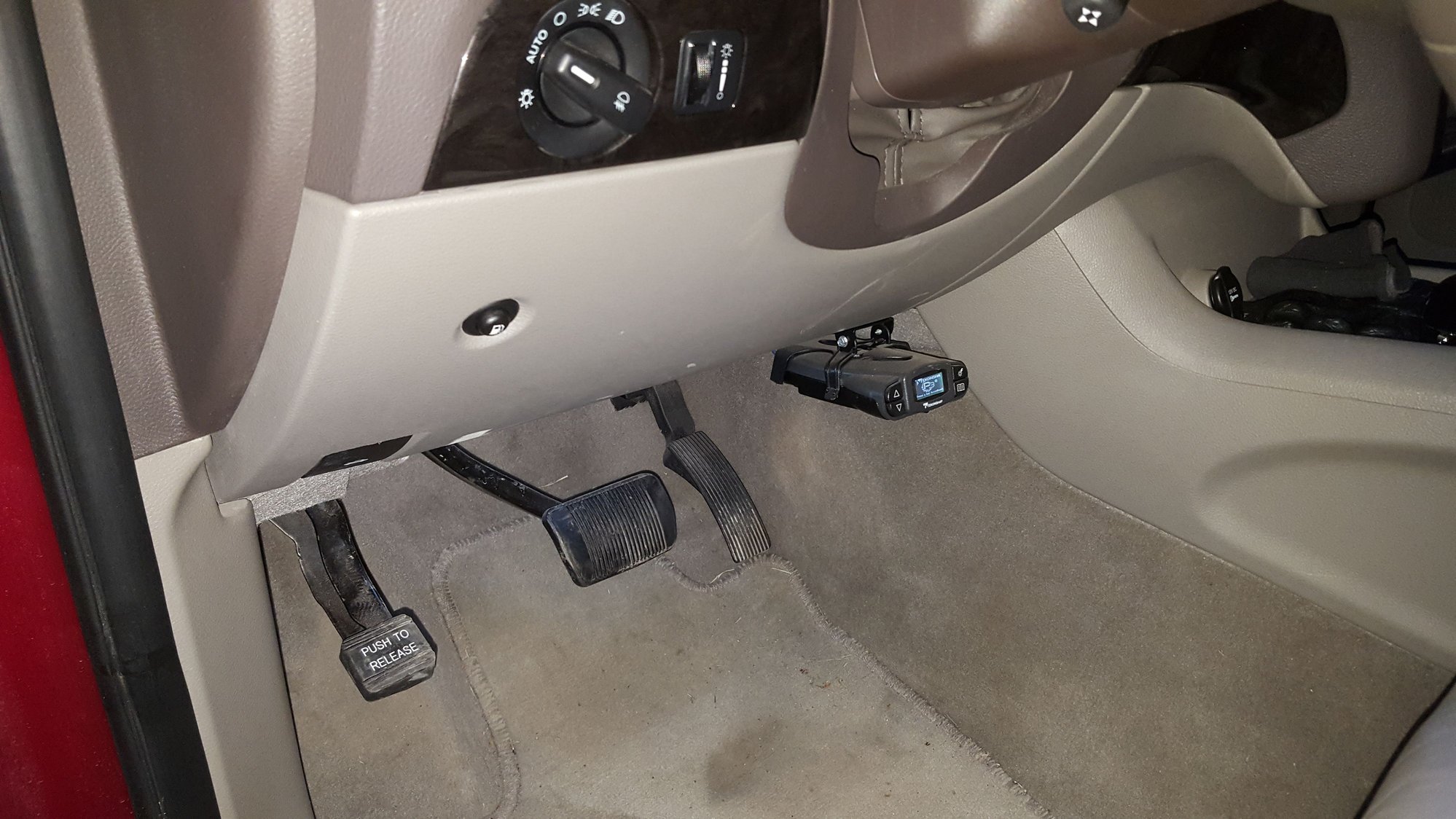

Here's where I have my brake controller mounted.
Location of Tekonsha P3 in my 2011 Durango

Yup, Prodigy is the one to get. I mounted mine like the photo, but on the other side, by the parking brake. I tow a 6600lb Airstream with no problem.
