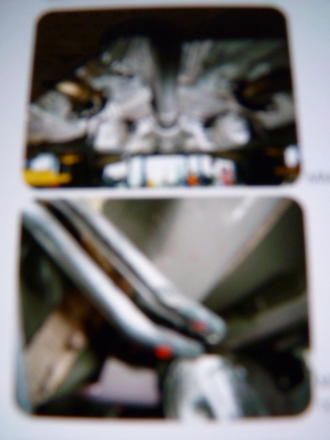

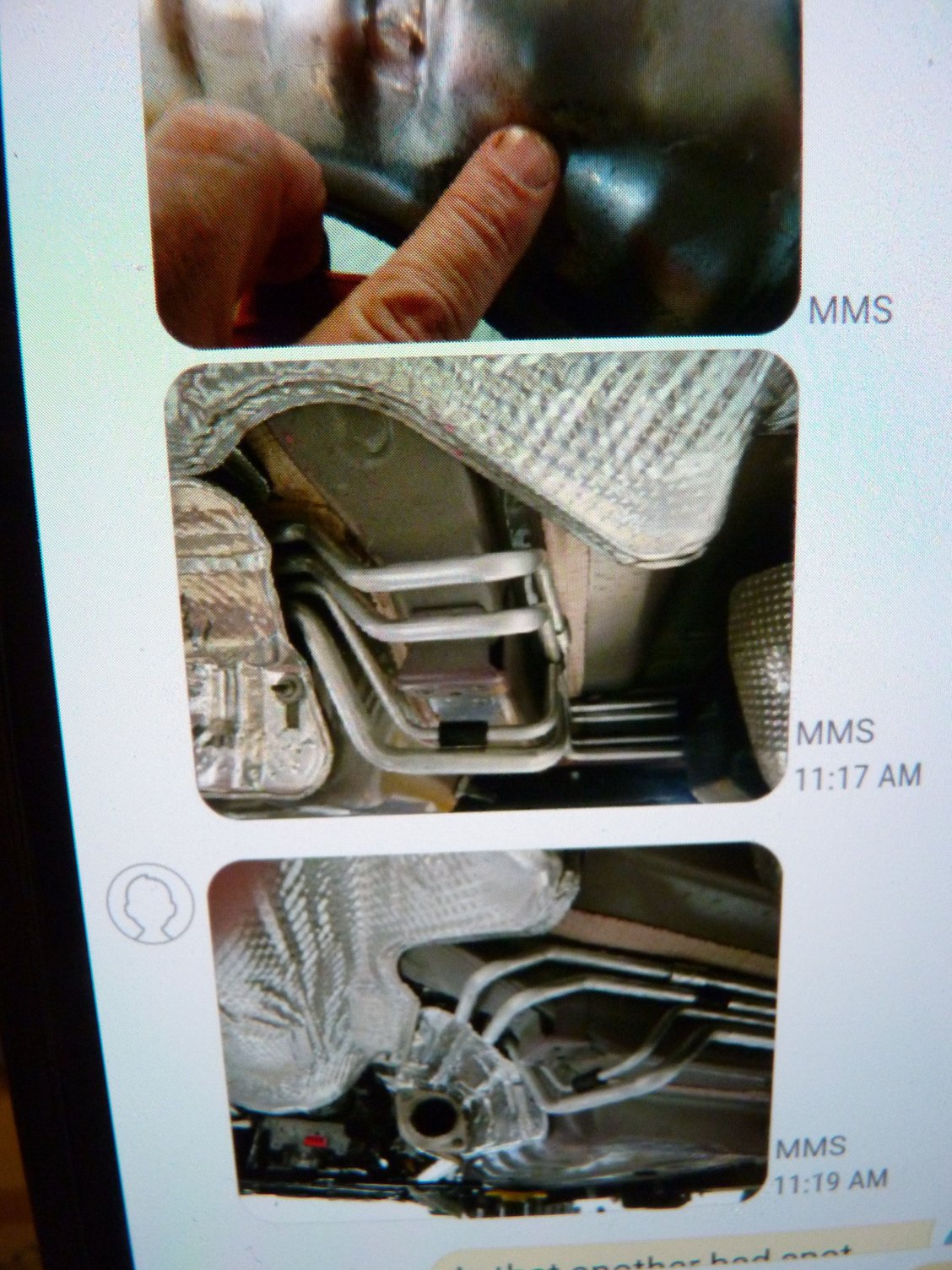

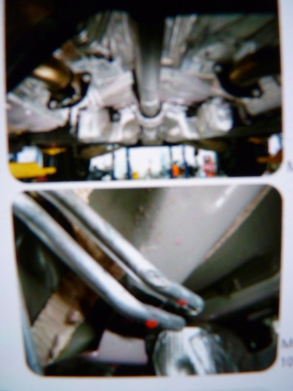

Durango 2020 RT. Happened 1/2/2022 - SUV 1 yr & 3 months old with 68oo miles. Few days noticing leaking coming from under right rear seat area, red/pink color, getting worse. Finally everything just poured out. Four miles from home & temp gauge starts going high, got audible message of overheating. Pull over 2nd time & still losing all fluid. Towed to dealership.
Firstly, chrysler towing service was worthless as was my own insurance, called local tow & paid out-of-pocket.
The dealership lacked in communication skills & it took 1 1/2 days to find the problem. For warranty service the tech must be certified. Diagnostics & pressure testing took forever.
They tell me the rear heat supply line shifted out of place & was resting up against the exhaust, causing a hole to be chewed away till it finally blew through. The coolant was running along the exhaust pipe.
Dealership people tell me this is a design flaw, with the pipe shifting over caused by hitting a curb, Said they never saw this before & yet a mopar repair kit was available, not going to put in a new pipe when a repair kit is available so dodge knew about this problem.
With a large SUV, heavy duty, pick-up truck chassis - how on earth can they say one minor slow speed run over a curb - can cause a pipe to shift out of place. And how am I to know it won't happen again.
Image: https://cimg8.ibsrv.net/gimg/dodgefo...506d672b29.jpg
Image: https://cimg9.ibsrv.net/gimg/dodgefo...7a78a341f7.jpg
Image: https://cimg1.ibsrv.net/gimg/dodgefo...a12ae284e7.jpg
right side pipe burned through just above bend
pipe burned through right at the bend on the right side pipe
