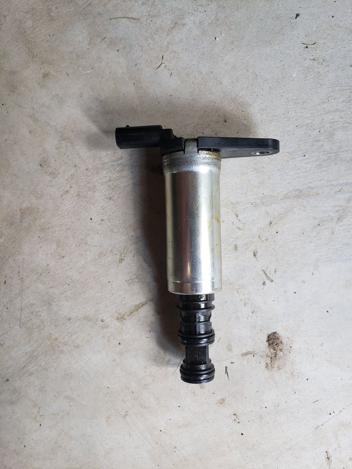

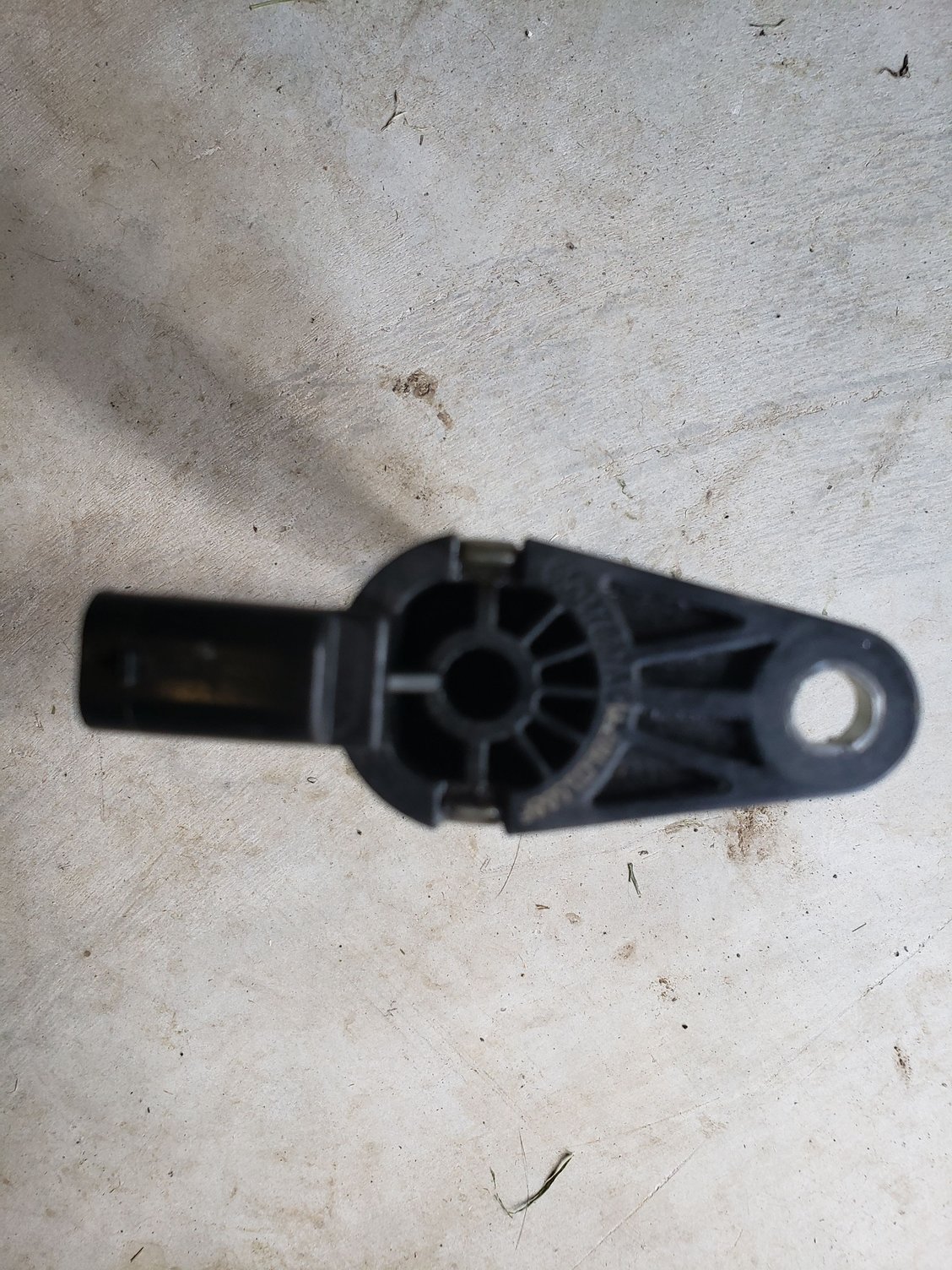

Yeah I was certain it was cylinder 2 i triple checked lol. That being said i solved the issue.
there's a solenoid that controls the oil for the valve timing. There's 4 on the car. 2 at the rear of each bank.(they control 3,5 and 4,6 respectively) but there's 2 more at the front of the valve covers just in front of # 1 and #2 coil packs. That baby goes bad mechanically will cause misfires. What i did was swap them and clear dtcs. Then drove it and bingo cylinder 1 misfire. $160 plus tax later and a bit of time retaking the intake off and problem solved for now.
