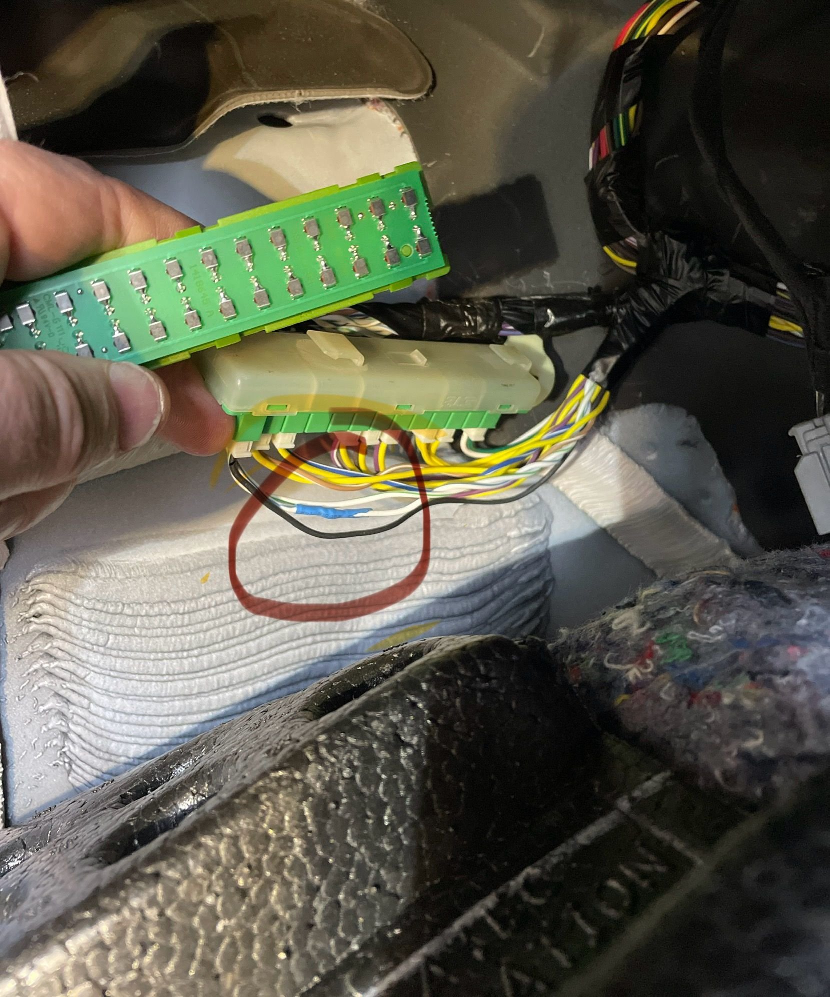

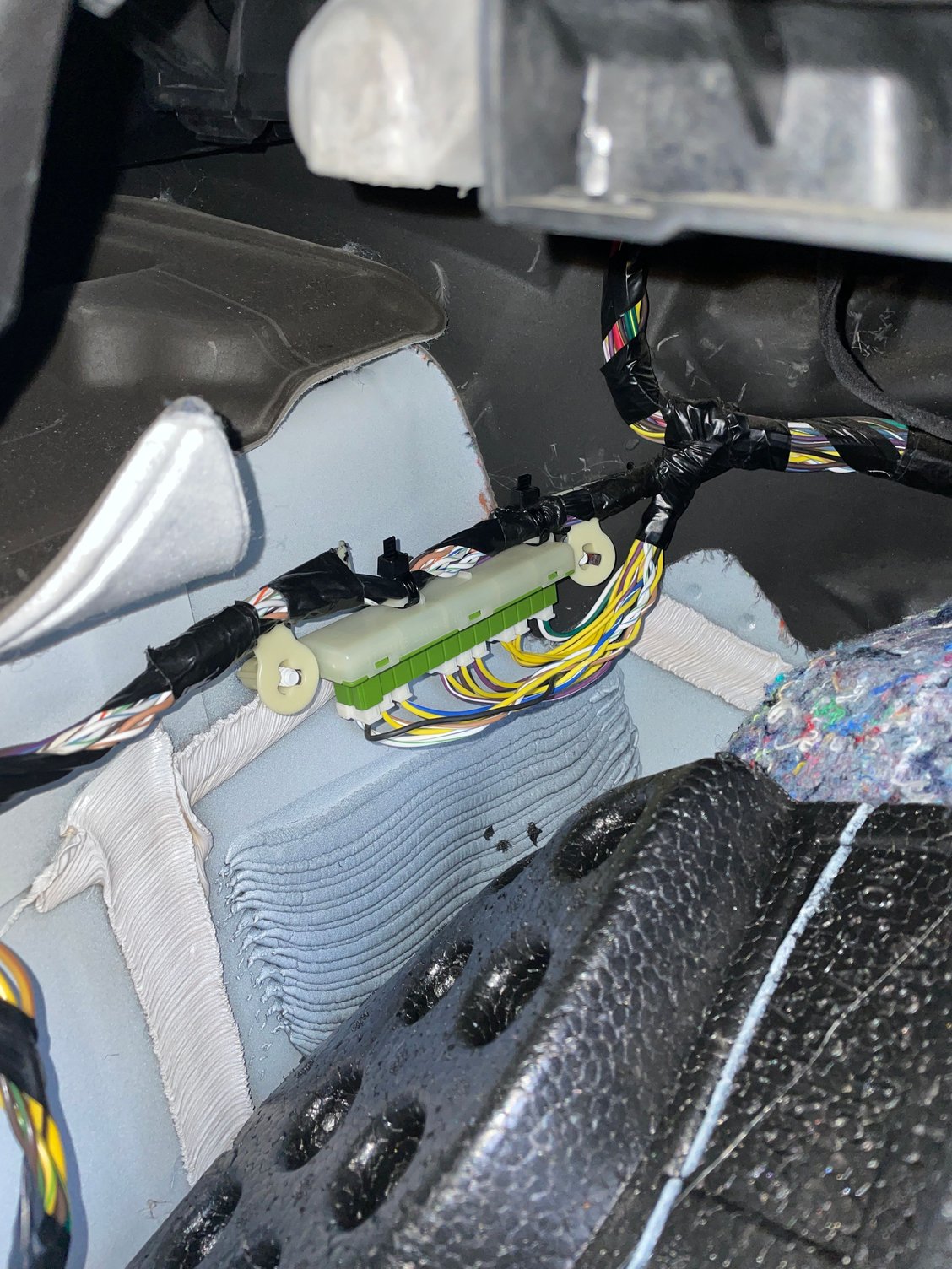

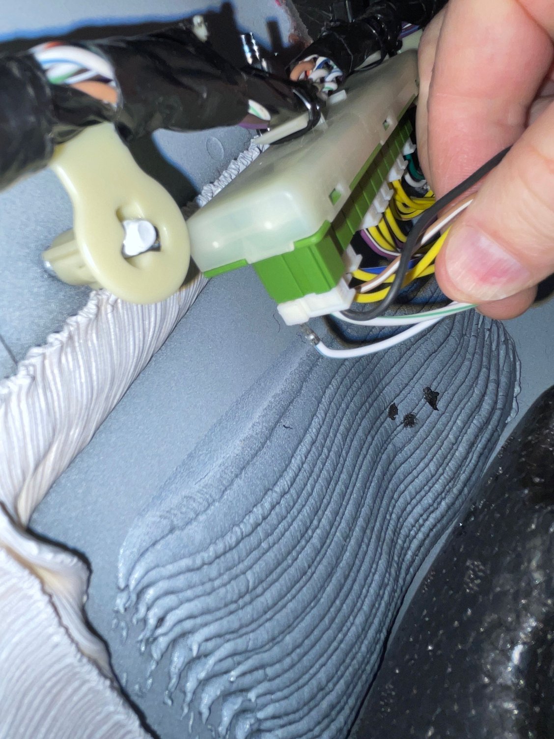

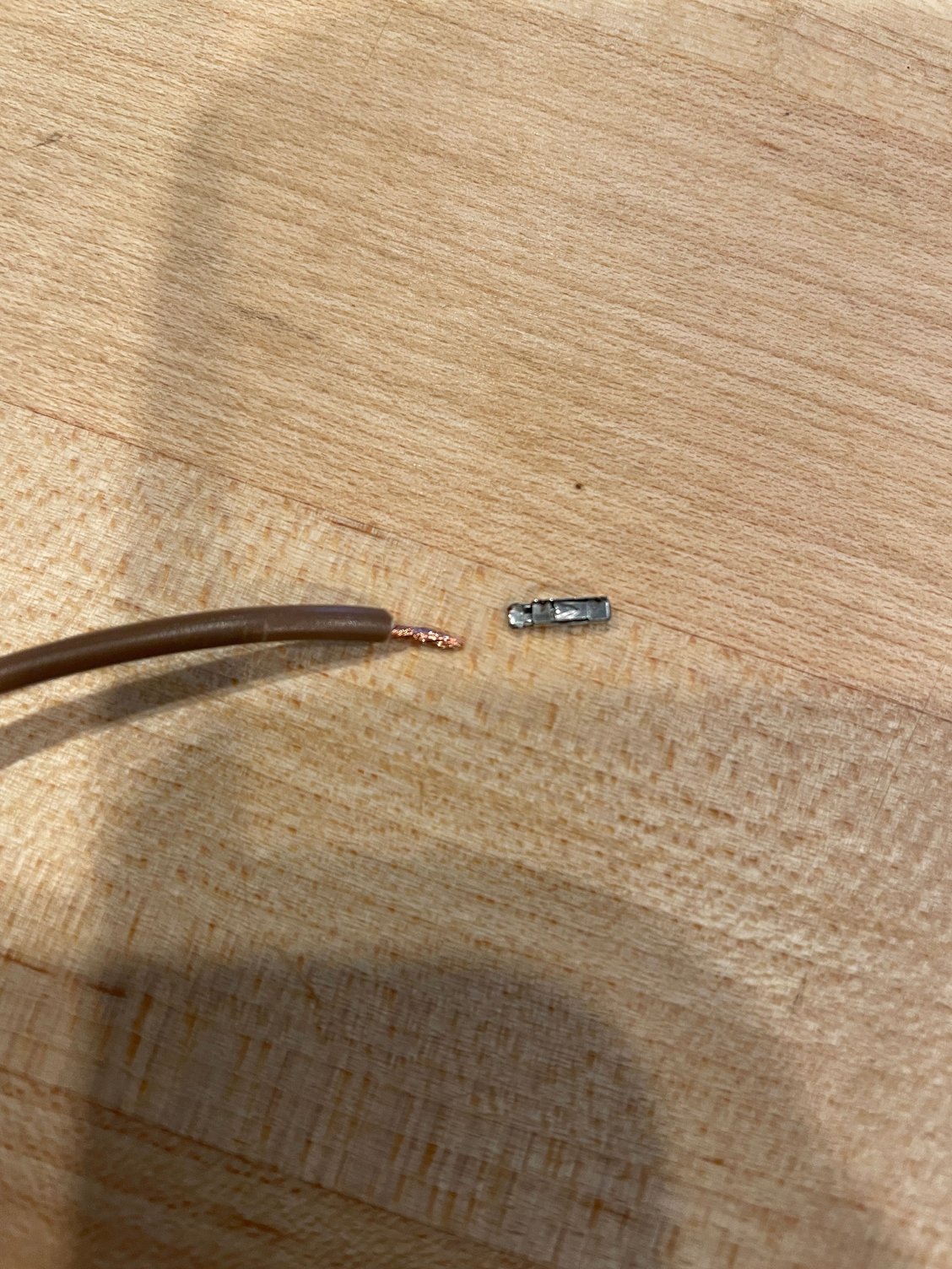

Old Dec 26, 2023 | 10:44 PM
Resolver's Avatar
Resolver
Joined: Dec 2023
Default Random U Codes, no entry, no FOB entry/start, black dashboard, random wipers, lights
Originally Posted by Lanabel
I have a 2013 Dodge Durango crew 3.6 2WD. The past few months she started having issues. I could feel I was losing power when driving and lights were kind of dim. Went and had my battery tested, said it was bad, replaced battery. Could still feel hesitation when driving and getting bad fuel economy. Eventually she threw a code. It came back as the cat. Took it to the mechanic and they suggested using cataclean because it looked like it was still in good condition and I could get 20-30k more miles out of it. Used the cataclean and the code cleared. Fast forward, I was leaking oil and they had to replace a bunch of parts including the “oil cooler”. She’s still not driving well. I can feel resistance when I drive and now it feels like the tranny is slipping or not shifting properly. On top of that, the tire pressure light went on. It’s not registering a tire. The radio doesn’t store memory sometimes and weird sensors don’t work periodically. It didn’t register my daughter in the passenger seat the other day and the fuel economy gauge started going crazy. Could it be my PCM? We’ve already thrown $2000 at my vehicle and the mechanic said to just wait until she “throws a code”, which seems like a shotty idea to me. I don’t want to ruin my transmission. I really love my vehicle and I just want it running back to normal. Any help is appreciated.
2014 DD R/T okay, want you to look for this Com Bus Port which located on passenger side under dash, under carpet and against center column and almost at firewall. I had random issues driving me crazy for past few years and progressively got worse. Vehicle shut down while driving, black dash and push button start, no remote or fob entry or start, numerous codes especially U Codes, such as loss of bus communication, service ABS, transmission and just about every other module. Finally found the fix and stumbled upon this while replacing the blend door actuator on passenger side. I will post pictures and you will see a loose wire, which on first glance looked fine and normal until I wiggled it (truck not starting at that point) and all of a sudden powered back up. Wire fell out and terminal pin was broken inside. Also when removing the white cover noticed solder joints were broken and pin was extending freely through solder joint. Replaced the bus port and repaired the wire and have had no issues since. So relieved and I hope this helps others across Dodge and Chrysler products that have similar issues and com port.
