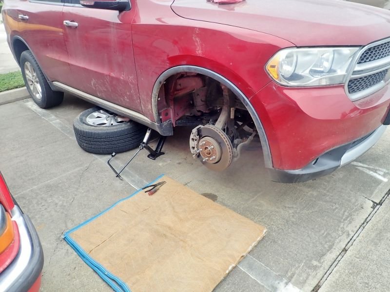

Wheel off. Ready to fit the new fender liner inside the wheel well. Tire under the car just in case the jack gives out, so I don't get crushed. You can see the bare bones inside, which are normally covered by the liner.
